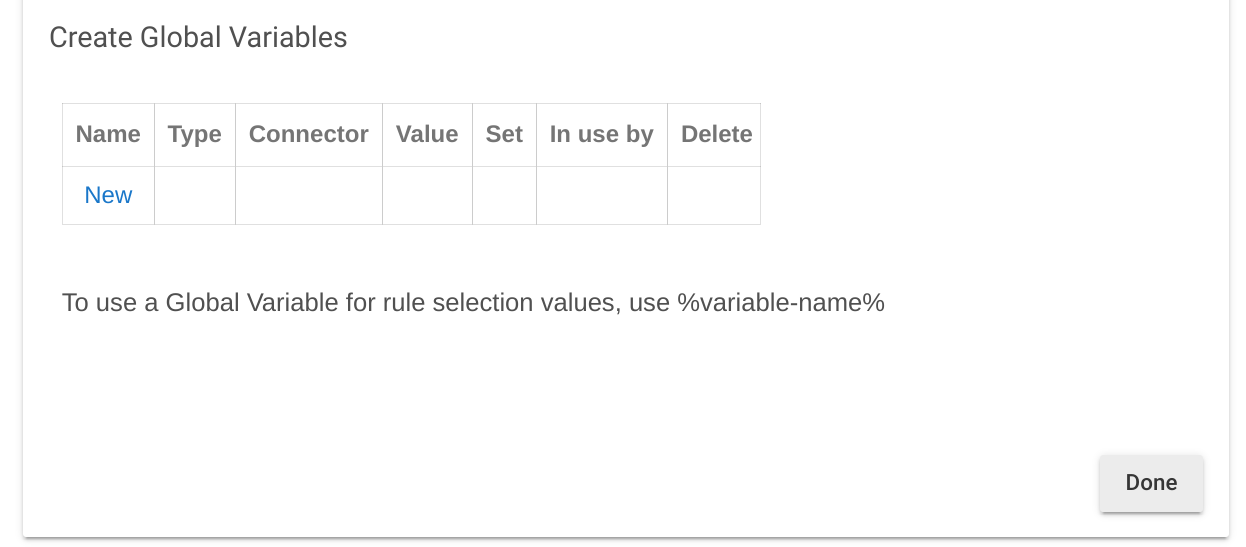

The picture below is immediately after making a new global variable of type boolean, initial value=true. Also tried refreshing the page a few times, no variable shows up.

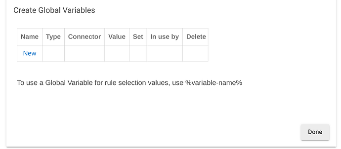

As soon as I select TRUE for initial value, the screen refreshes and shows the picture below:
OK, I'm able to confirm this is broken. Will investigate.
