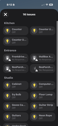

I am having the same problem with devices exposed to the homekit bridge integration. I have three devices no response, a govee strip, a hue floor lamp and a virtual rgbw. they all show no response but the other devices work fine. I am on hubitat 2.5.0.143
I am having the same issue on Govee and Hue No response they work but show as an issue, running newest update

For me it’s happening on all RGBW bulbs unless they are in CT mode. As soon as they switch to RGB mode they go into No Response in HomeKit.
I just updated to 2.5.2.129 and appear to be having a similar problem. I reverted back to 2.4.3.131 and all is working again. Has there been any fix found for this yet?
