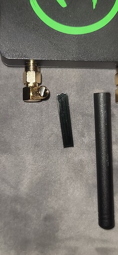

I broke one my antennas as I try to move it and didn't realize that the black housing had slid up far enough that it caused the antenna board inside to snap off when I tried to move it. It snapped at the metal L connector. It was foolish probably to do as I have severe nerve damage in my left hand and muscle atrophy but I I try not to let such things get in my way to do things.

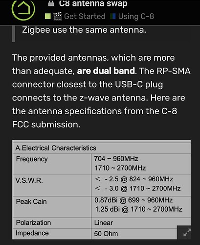

I know for a close replacement it should be approximately 1 to 2 DBI else I understand it starts being a little bit more directional than omnidirectional. It's Dual frequency according to the picture I found telling the specs of it.
