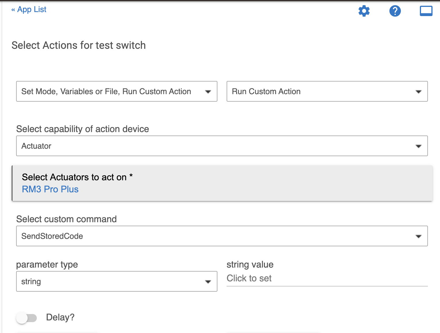

Can anyone help me put a IR Code into a virtual switch so hopefully i Can use in Echo,
I have Broadlink set up and learning code and i can create a Virtual switch just can't seem to find any way to insert the learnt code with Rule Machine
any input would be appreciated
Ok figured a few things out , Do I need to select the parameter type and enter the code ??
UPDATE
Ok just an update for anyone wanting the same thing, in the end I selected "sendcode" and entered the IR code stored in Broadlink app and it seem to work, would be nice to be able to select the code instead of cut and paste , but it worked so thanks to those who created the app and drivers
