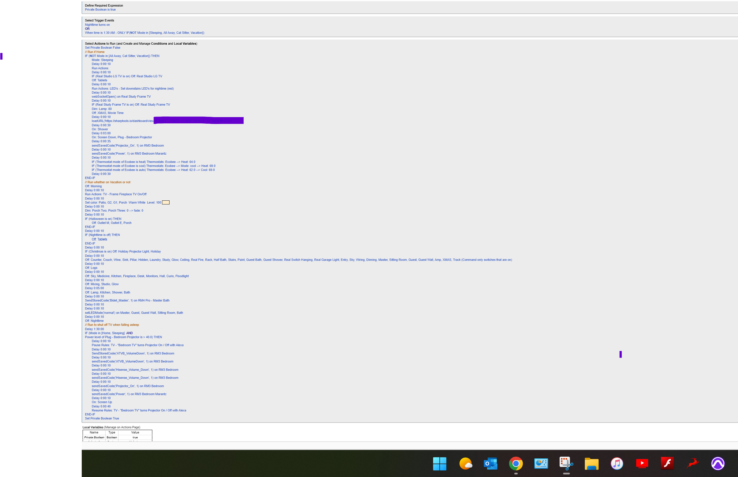

I’ll post a rule when I get home…tell me what’s wrong

Rule screenshot
Is that a representative example of your rules? What are we looking for?
All of my rules are much shorter and simpler. I tend to avoid multiple delays and a long stream of conditionals.
This is what’s confusing me.

That is a monster rule.
I don’t think I could ever keep track of so many things going on in one rule.
I favor more rules with fewer moving parts in each one.

Looking at your rule, it's not at all clear why you even need to protect it. What we can't see is what causes 'nighttime' to turn on. That's the only possible source of multiple executions of the rule.
For those who need to protect a rule from multiple simultaneous instances, the best approach is to use Private Boolean in a Conditional Trigger (rather than in a Required Expression).

My preference has always been to be able to see everything in one place vs. having to jump from rule to rule trying to hunt down issues. Nightime and Morning are the longest ones of course since the most changes.
I have a couple of questions about your rule.
First, I wonder why you are using Private Boolean at all? I'm guessing it's because of the last section — run to shut off TV when falling asleep? I can see that the long delay before that section might cause it to run at or after 1:30. Could that section be moved to its own rule?
Second, I'm genuinely curious about why you have a delay between every step. I've only used a handful of delays in my rules, and always in a case like your last section, where I want to wait until I know that a previous step has completed before kicking off the next step. And I'm more likely to use Wait For Event --> Elapsed Time.
