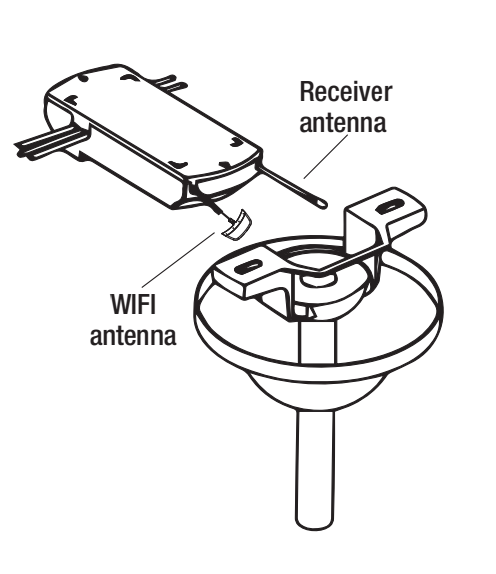

Anybody using these? I've had two of them for quite awhile, and really like them. But I've always had wireless issues with one of them staying connected. When it does, it gets poor signal despite being only a few feet away from the nearest AP.
Is the antenna that hangs out of the canopy the 2.4 wifi antenna or the antenna for the remote?
These are what I'm talking about

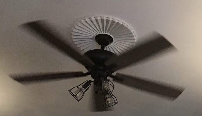

Not sure which antenna is for Zigbee and which is for the remote. I routed both antennas outside the canopy by cutting a notch in the canopy where it meets the ceiling. Then I used a ceiling medallion to cover the antenna wires. The medallion is two pieces and is made of sturdy foam.
I suspect the black antenna wire is for the RF remote and if that big white antenna in the pictures is on yours that is probably the Wifi antenna, otherwise it may be internal.
Reasoning is that black wire looks exactly like the RF antenna on many other devices.

I assumed the big white antenna is the wireless but it's outside of the canopy and practically line of sight from the AP.
