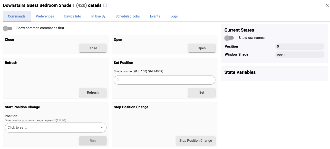

After the recent update, the Bond Bridge and Shades are showing in Devices but the Open/Close commands do not work and the Current State is inaccurate.

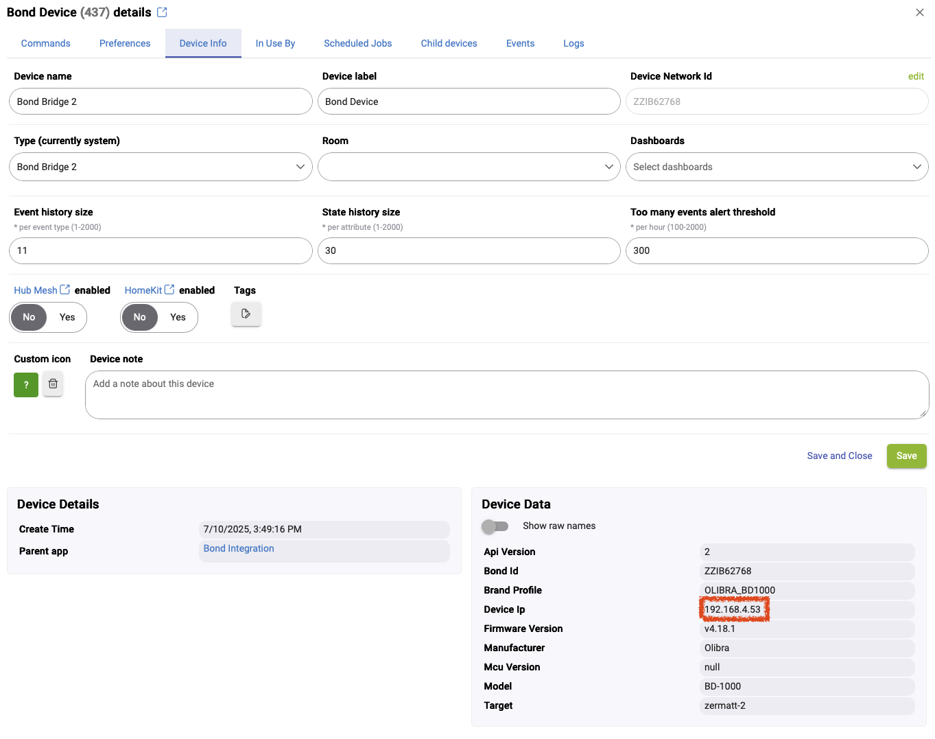

The Bond Bridge (192.168.4.53) is in the same subnet as Hubitat (192.168.4.51) and both have reserved IPs.

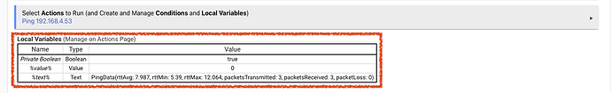

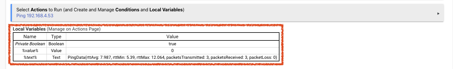

The Bond Bridge (192.168.4.53) is pingable from Hubitat and other devices.

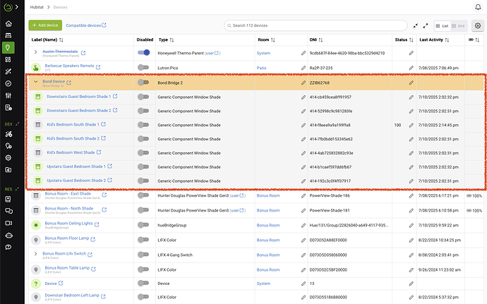

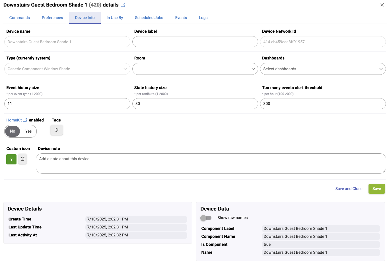

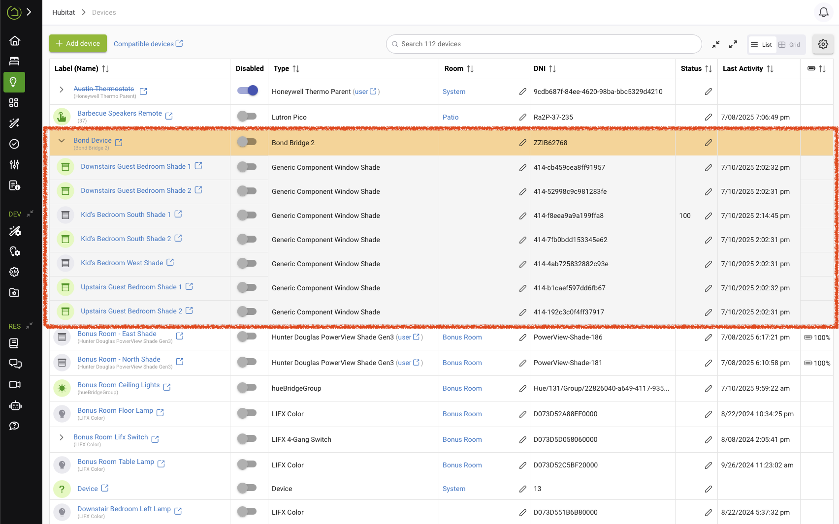

  4. The 7 shades auto populated under Bond Devices in Devices
Problem:
The shades State (open/close) is not accurate and the shades do not respond to the open or closed commands from Hubitat.
