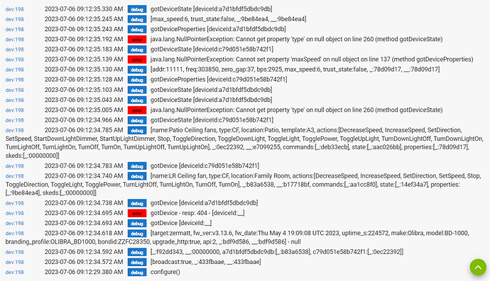

Below is the event log from the time I added the Bond Controller. The very top error message is me trying to set the fan speed.

Your Bond device is only showing one attached device in the data, but you have two child devices attached to it?

It auto detected both my fans (LR Ceiling Fan, Patio Ceiling Fans) and created those devices. (Log is attached).
