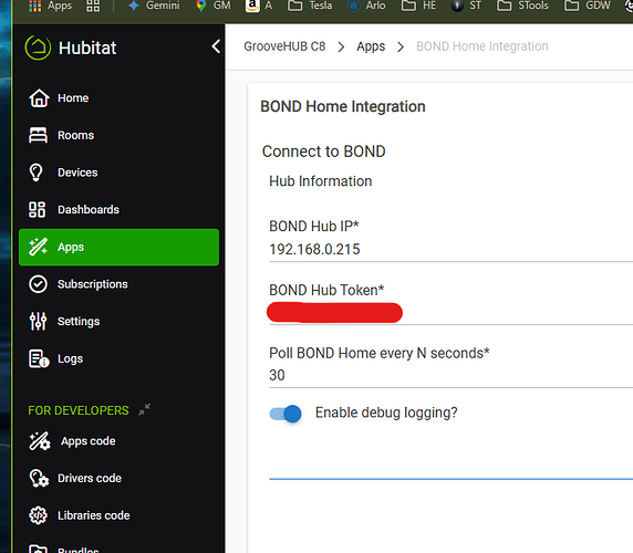

I switched to a NON Hubitat Package Manager APP/Driver and it gives you the ability to change IP adresses.
Interesting. Thanks for sharing. I guess I will have to try that. Disappointing that they are not the same app/drivers.
Also this other driver allows for some extra settings as well and each device is a device as opposed to a child device (I think).
