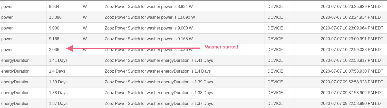

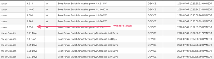

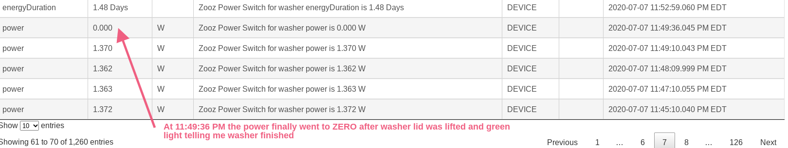

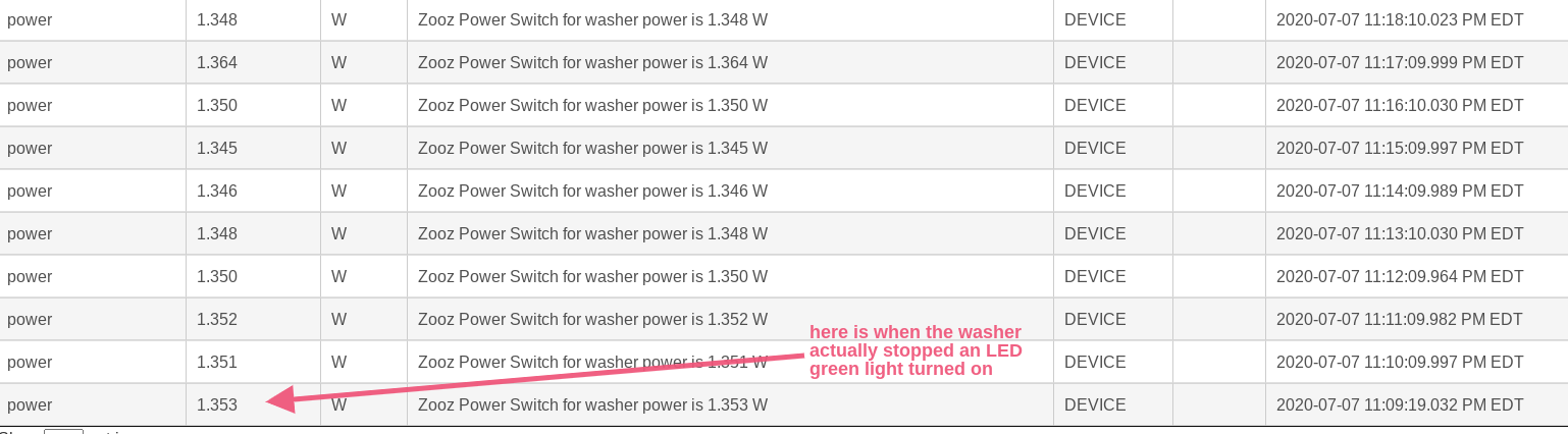

I've done exactly what Hal had suggested and listed below and documented the events that occurred. Much appreciate you and Hal's help.
First image is of event page when I lifted the washer lid after machine was off awhile and then green light went off

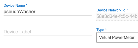

Ok, I set up a child for you... matching the screencap... using this device as the Sensor:

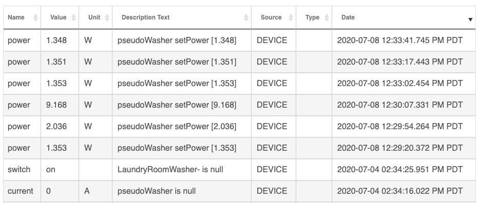

and after the 3 minute delay/wait you set, the Cycle ends.
Screen Shot 2020-07-08 at 12.39.51 PM
and you can see the Events for the power switch match your 'pattern'
OK so I'm fine with 8 watts to start cycle but after that I'm lost. Does your report mean the rest of my settings are ok or if not I'd accept your recommendations to change any settings to a specific number
I just matched the values you show in your screencap here:
You can see them in the logs:
thresholds: 8.0 4.0 2 1500.0
Me again. I would increase both start and stop to 8 watts. Keep in mind that you don't really care much about how quickly it detects start. You are primarily interested in how well it detects end. Start would be hard to miss because the washer will eventually draw 100-300 watts when the motor starts. But end times just take a lot of experimenting to figure out.
I wouldn't count on any electronic device to show zero when it was "off". There are electronics powered at all time to monitor the controls to see when you start pushing buttons, and it does maintain state of some settings (or at least mine does).
Mine are set 'high' too.
I don't really want to know when someone opens and closes the washer lid or while the washer is filling for the first time. I want to know when the motor comes on. Equally, the rinse cycle has no motor, but the water Inlet valve draws some.. so I want "low" to be lower than the valve's power, but way above zero.
I don't NEED the optional values.. but I want to be sure it's working correctly so I put something in there.

From my testing, the Thresholds you picked are OK.
You chose a delay of 3 minutes, and I guess I would put a question mark over that...
The idea behind "Stop after power has been below the threshold for this many..."
"sequential reportings" vs "continuous minutes" is... pick one or the other.
If you use Zero as the low threshold, then there's a strong chance the de-duplication action of the Hub will not send two Events. Therefore, it will sit at the last reading forever and never indicate Cycle Complete. SO.. wait 3 mins after the one-and-only zero is an alternative. You are picking a low threshold of 4Watts and the readings dither just enough that you'll get multiples that are not precisely the same. Instead, I'd use the 'deadman' option to force a Cycle Complete after N minutes. Again, measure the values, time the cycle. :smiley:
