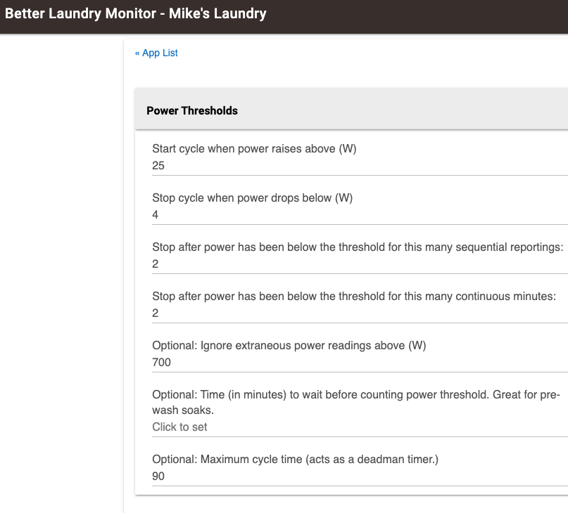

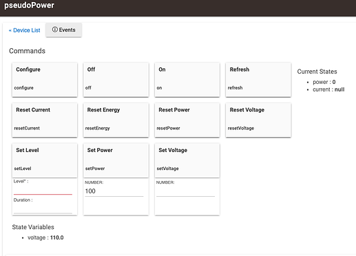

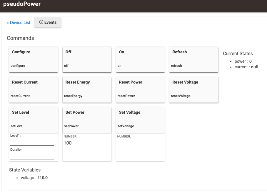

I've tried to duplicate. I created a Virtual PowerMeter and setup BLM to monitor it.
Using the Set Power tile and the Reset Power, I tried to quickly simulate your graph. Obviously there's no need for me to manually peck in 300 data points. Crossing the set thresholds a few times should be enough to demonstrate.
Logs:

As you can see, the "stop" threshold was crossed several times, followed by values above the stop threshold. as shown by: "We hit the delay 1 times but cleared it"
The last log is:
We hit delay 1 times
And there it will sit til another Zero Power message arrives OR til the 90 min deadman fires.
I'm torn here.. in simulating your numbers.. do I fire another Zero Power message and thus show that it correctly ends, OR wait 90 mins...
I think I'll send the Zero and verify that, at least.. then alter the Thresholds to have a 9 min Deadman... and do the whole thing again.
I did, and the Logs show:
app:434 2020-12-13 08:31:09.817 am debug Cycle finished after delay.

I'm going to alter the Thresholds and try again...
2nd pass Logs:

And now I'm just waiting on the 5 min Deadman timer...
app:434 2020-12-13 08:48:29.999 am debug Cycle finished by deadman timer. State: false
app:434 2020-12-13 08:48:29.963 am debug send: Mike's laundry is done
app:434 2020-12-13 08:45:49.037 am debug We hit delay 1 times
So... the results follow my expectations. In addition to shortening the Deadman delay to 5 mins to speed the test results, I cleared the Stop Power for Continuous Minutes (4th Threshold value). The Stop after Sequential and the Stop Power for Continuous Minutes (3rd and 4th values) are rarely needed together, usually it's one or the other.
I made the changes that you suggested and got my notifications. Thanks for the help with this.
