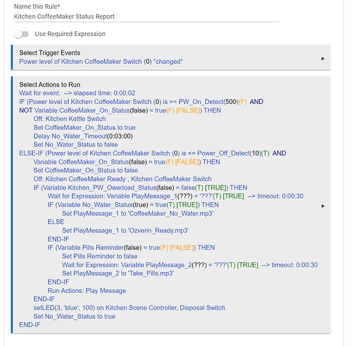

Here are few RM rule related to the Coffee Maker I mentioned above.
Coffee Maker switch is always in ON position and never touched.
On/Of control is done by Power Plug with Power Meter capability.
Of course, Coffee Maker must be manually prepared.
Once this is done, the rule "Kitchen CoffeeMaker Ready" is triggered
by pressing one of the related button (there are few around).
When someone is ready to actually brew coffee another button is
pressed. The rest is done by the above RM rules.
This should give you an idea how the think is automated.
Here is an example of Button rules.
Only Button-3 rules are related to the Coffee Maker automation

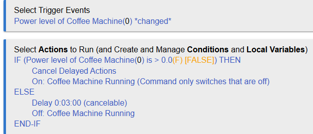

I plugged the coffee maker into an Eightree Zigbee plug I had laying around.
What I found is that after brewing, the maker drops to near 0 power consumption for almost 2 minutes at a time. So I couldn't just use a simple rule to turn off the plug after 2 hours.

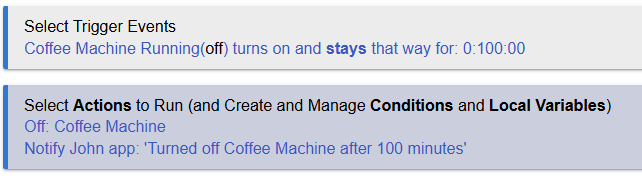

Rather than using a complicated rule to figure this all out, I just added a virtual switch (Coffee Machine Running) and this rule to control it. Basically, it turns the virtual switch on until the Zigbee plug (Coffee machine) reports power as 0 for 3 minutes.
This lets me use a trivial rule to turn off the power to the coffee maker after it's run for too long. I use this rather than csteele's auto_off app as I wanted a notification.
