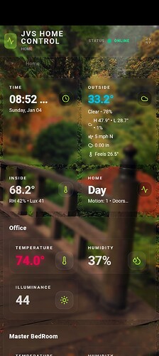

I’m sharing a beta of a custom dashboard I built for Hubitat that will be a wall tablet/kiosk. It’s a single Node/Express service that serves both the API + the built React UI.
Repo: GitHub - jeamajoal/jvshomecontrol: website
What it is
  • Firstly, it is a work in progress
  • Hubitat-backed control panel (React UI + Node backend + realtime updates)
  • Built for kiosk/tablet use (big touch targets, fast refresh)
  • Pages include Environment/Home, Climate (heatmap), Weather (built-in Open‑Meteo), Activity, and Controls

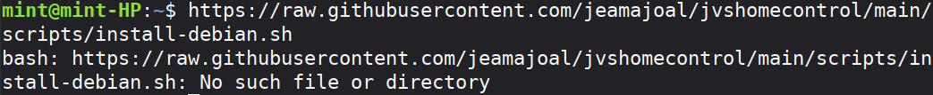

Hello.
I'd like to try this out.
I copied and pasted the install link on my linux mint machine, with the following error:
Am I installing it correctly?
Linux Mint is fine (Debian/Ubuntu-based). Don’t paste the raw script into the terminal—download it to a file and run it with sudo so the prompts work properly.
First install (recommended)
cd /tmp
curl -fsSL https://raw.githubusercontent.com/jeamajoal/jvshomecontrol/main/scripts/install-debian.sh -o install-jvshomecontrol.sh
chmod +x install-jvshomecontrol.sh
sudo bash ./install-jvshomecontrol.sh

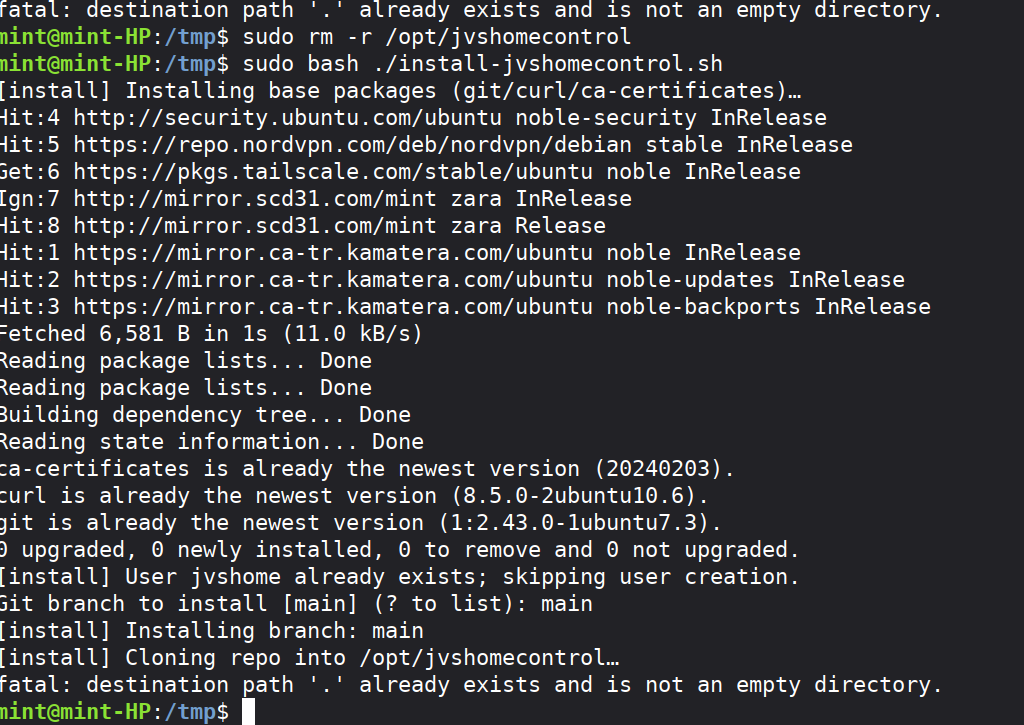

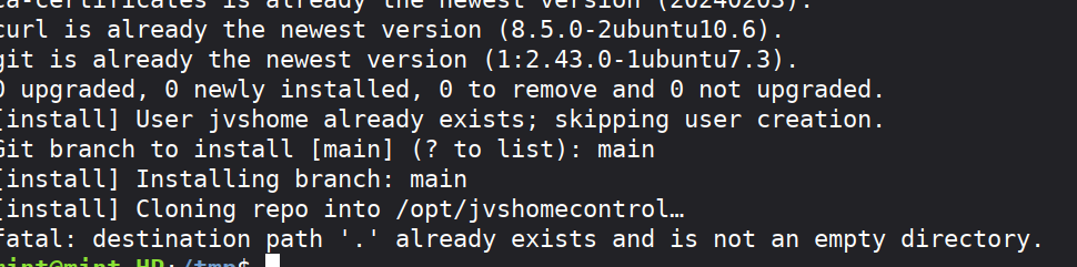

Hello, still having an issue:
It looks like the /opt/jvshomecontrol dir was populated with something but not the .git file so git refuses to clone into it. just sudo rm -r /opt/jvshomecontrol then run the installer again.
Same error:
I'm sorry you are having issues. I have had no luck replicating the issue. I may have leaned to heavily on the scripted install hoping it would be the one hit wonder. Rm the dir and instead of running the install script please git clone https://GitHub.com/jeamajoal/jvshomecomtrol
Then run the install script from the jvshomecomtrol/scripts dir.
