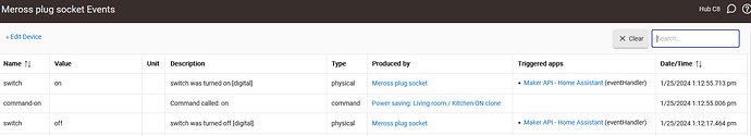

Yep, it seems to be sending status..
Do you see in the Events window which app is sending periodically the on() command?

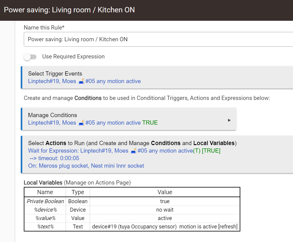

Interesting... it seems to be called by a rule...
In my opinion, when a driver command on() is called - it should be executed unconditionally, no matter what switch state the driver 'thinks' it is ... last state may be wrong. So the driver should not filter commands.

I have removed the plug from the rule and re-subscribed to controller events and it seems to be behaving now.

One thing that still confuses me is that I have a 2nd meross plug on another rule and that one does not have this polling issue?
This rule will be triggered with any update of the humidity readings from the bathroom sensor. The rule will turn the plug on every time when a new humidity event above 65% is generated by the sensor..
I think it’s OK as it is.
Yes, this has been working fine and there was there was only 1 hub action for the device compared to 688 hub actions for the other meross plug.
Anyway, I will not use the problem plug for now, thanks.

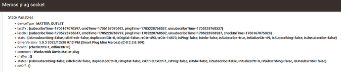

It is very unlikely that the problem is in the Meross plug...
Are you using one and the same driver for both plugs?
Yes, your driver...

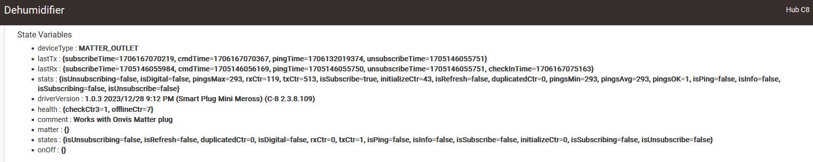

TxCtr (the number of thetransmitted messages) is too high for both devices.,,
I should probably add an auto-reset of the statistics on the HE reboot.

I have now made one minor change to the rule (command only switches that are off) and all is well, rule has been running it for a few hours well, thanks.
