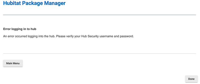

This crashes for me each time I run it. It says the user name and password for the Hubitat is incorrect. I entered it twice to make sure it is correct.

Do you have Hub Security turned on (it’s off by default)? If not remove the user name and password.

Thanks for suggestion. I thought it was enabled, but in checking it was not. The only way I could get HPM working was to remove the app/code and then add the code back in again. Works great so far.
