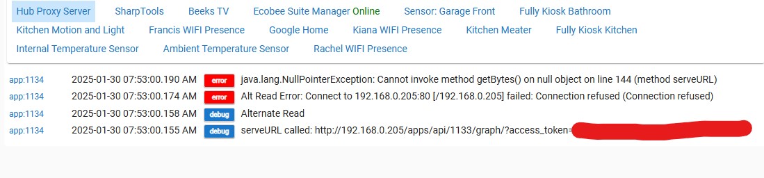

Try using port 8080 on the graph URL, i.e. http://192.168.0.205:8080/apps/api/1133/graph/?access_token=xxxx-xxxx-xxxx-xxxxxxxxx and then re-encode (port 8080 is required because the hub will be calling itself and thus occupying port 80)

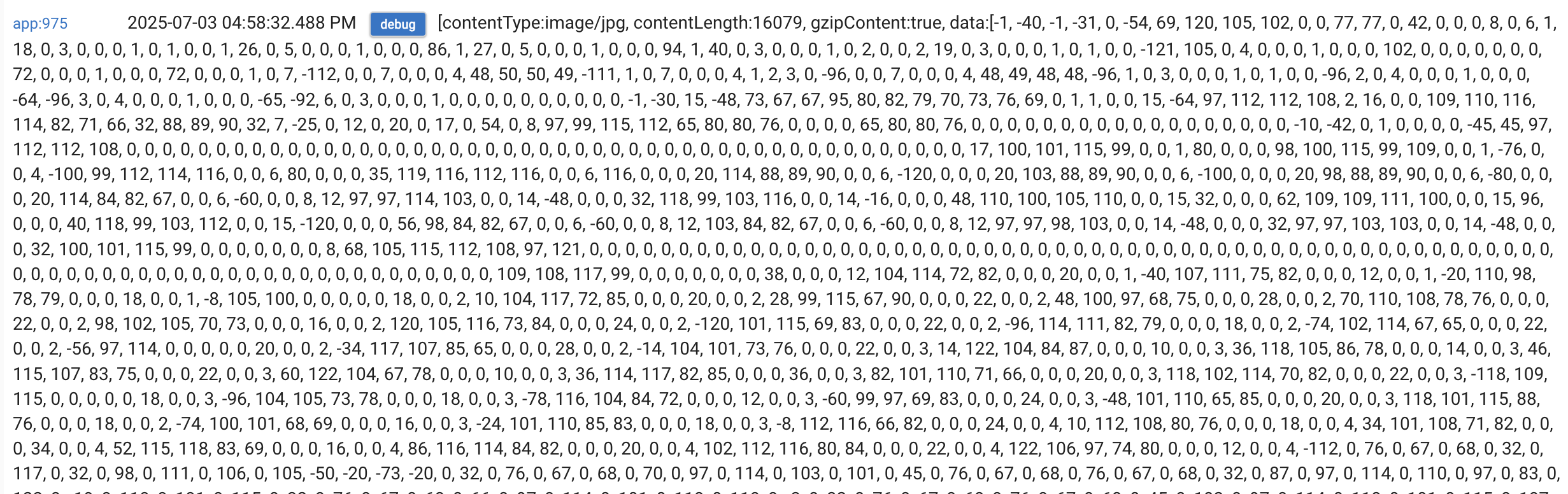

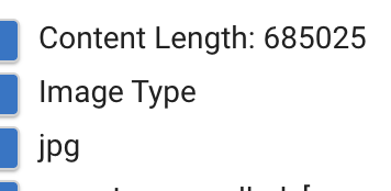

@thebearmay - have you or anyone else been able to serve images via the cloud endpoint?
I tried with a 685k image and trying to access via the cloud URL hangs for a while and eventually returns with No response from hub. I see the app got the request:
I tried again with a much smaller image and got the same response.. so maybe not related to image size? The 2nd one was only 16k
