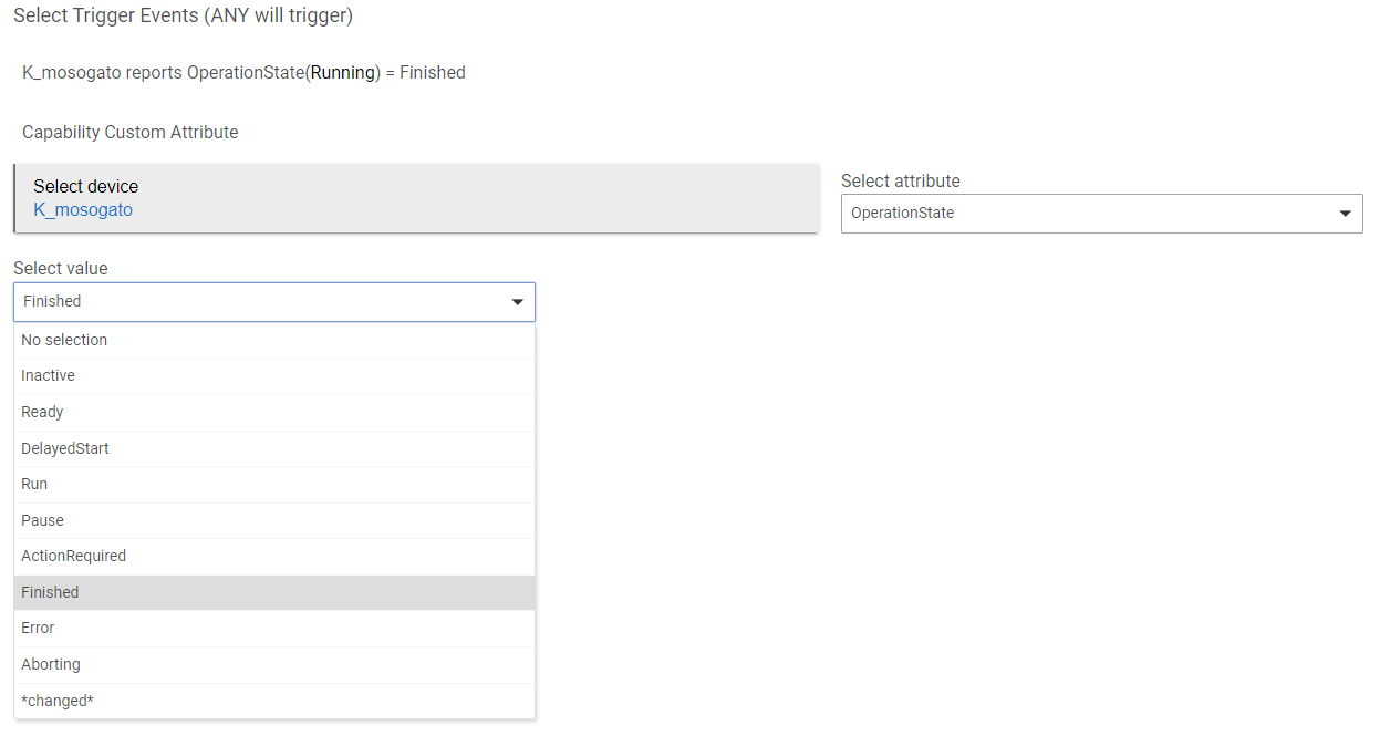

Just fixed that, new version available. Please let me know if it works :slight_smile:
I deleted the Dishwasher and re ran the setup after updating the app and the errors are gone. However, I've just written an RM rule to notify me when the cycle is complete and it did not trigger.

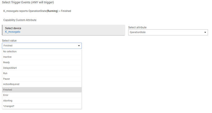

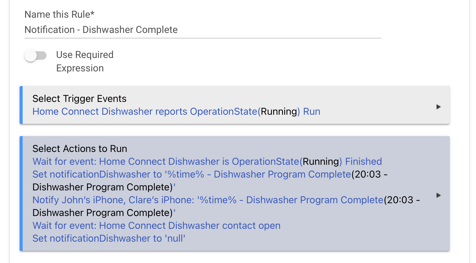

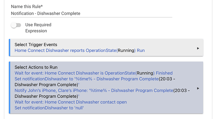

The trigger is when the Dishwasher reports "Run" (as that is what is available for selection) but what the Dishwasher actually reports is "Running" which is not available and so the rule won't trigger. A cycle is "Running" at the moment which shows the issue in the "Select Trigger Events"
And here is what is available for selection in RM - Custom Attributes, operationState:
Re: the above I've amended "Run" to "Running" in the driver code as shown and I think that's all that's needed to fix it:

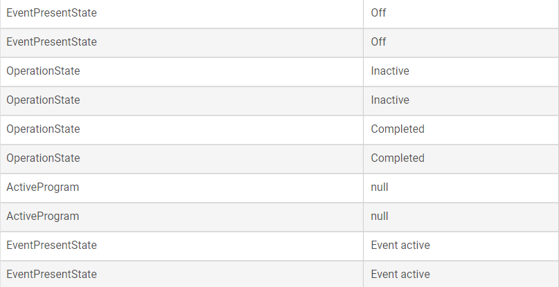

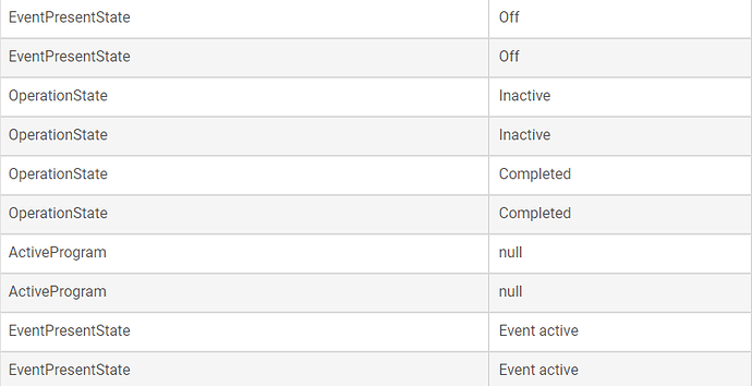

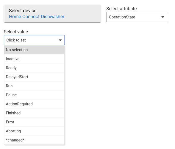

Hi @rfg81 !
Thank you for your work, i am using this every day :slight_smile:
Today i wanted to set a notification when the dishwasher finish the cycle.
When the Dishwasher has finished it will send a "completed" event as you can see here:
But when i want to set up a custom attribute on rule machine, there is no "completed" option in the Operationstate. Only "finished" but that is not matching, so the rule will not run.
Can we change that list to match it?
Brian
@rfg81 It seems there are a few of the OperationState events in the code that don't match what the Dishwasher sends out. It looks as though the info in the Home Connect API Documents is incorrect or maybe not up to date?
"Run" needs changing to "Running" in the driver lines 76 - 78
"Finished" states in the code that it is sent when the program completes successfully or is aborted. However when the program completes it reports "Completed"
@brain You could alter your rule to sent the notification when programProgress = 100% as an alternative or even operationState is inactive as it reports that immediately after reaching 100% and completed. Or you can just open the driver code and alter Finished to Completed as I did - it's at lines 88 & 90. Once changed you need to refresh the entry in your rule.

@brain and @johnwill1 I fixed your issues on the latest version. @johnwill1 you can revert the change you did. I'm going to support the official values from the API which is "run".

Thanks @rfg81

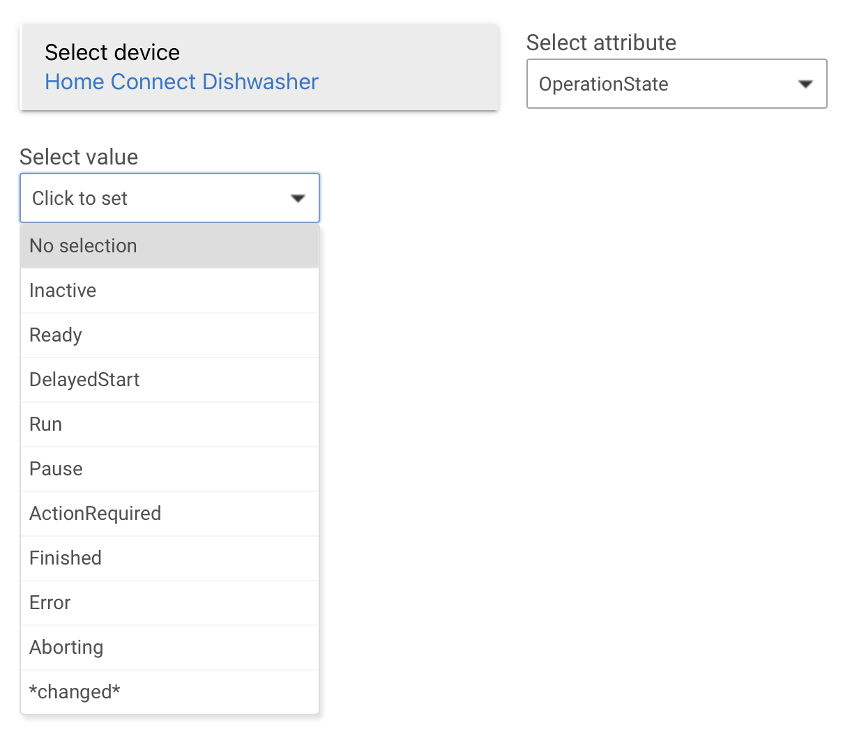

I'm a bit confused
If the Dishwasher reports "Running" when it starts a program and "Completed" when the program ends, how can we trigger rules if the corresponding OperationState events that appear for selection from the driver in the HE interface are "Run" and "Finished". The conditions to trigger will never be met as they don't match.
Apologies for querying this, I know nothing about coding so I'm just trying to understand it correctly.
The API sends me these options:
  • Inactive
    Key: BSH.Common.EnumType.OperationState.Inactive
    Description: Home appliance is inactive. It could be switched off or in standby.
  • Ready
    Key: BSH.Common.EnumType.OperationState.Ready
    Description: Home appliance is switched on. No program is active.
  • Delayed Start
    Key: BSH.Common.EnumType.OperationState.DelayedStart
    Description: A program has been activated but has not started yet.
  • Run
    Key: BSH.Common.EnumType.OperationState.Run
    Description: A program is currently active.
  • Pause
    Key: BSH.Common.EnumType.OperationState.Pause
    Description: The active program has been paused.
  • Action required
    Key: BSH.Common.EnumType.OperationState.ActionRequired
    Description: The active program requires a user interaction.
  • Finished
    Key: BSH.Common.EnumType.OperationState.Finished
    Description: The active program has finished or has been aborted successfully.
  • Error
    Key: BSH.Common.EnumType.OperationState.Error
    Description: The home appliance is in an error state.
  • Aborting
    Key: BSH.Common.EnumType.OperationState.Aborting
    Description: The active program is currently aborting.
So these are the values that are going to be supported by my drivers. You can use them on rule machine with my latest change (I'm sending the correct string to the driver).
Ahh Ok I think I understand. I'll give it a whirl and see what happens next program - thanks.
