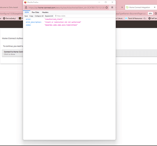

I forgot that when I deleted the app, the redirect url changed because the APP ID changed (the url redirect contains the APP ID) so once I paid attention to the install and copied the new redirect to my API account it worked...(Such an elementary mistake, ugh)
I discovered that when i was struggling to get it working the first time around and was reinstalling it from scratch for the umpteenth time. I don't remember exactly what I was going wrong but it was something stupidly simple when I found the answer. I find myself overlooking the simplest things sometimes.

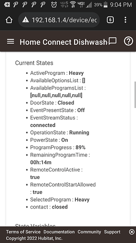

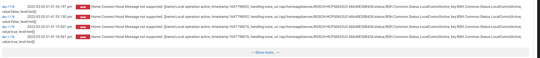

I can now see the RemainingProgramTime and ProgramProgress in the current states panel for my Dishwasher, since the update. However I've just started a program and all I get in the logs is the below errors:
@johnwill1 I just run a program and I couldn't reproduce the error. Could you please enable trace in the app and the dishwasher device log and get me the lines before the errors show up?
