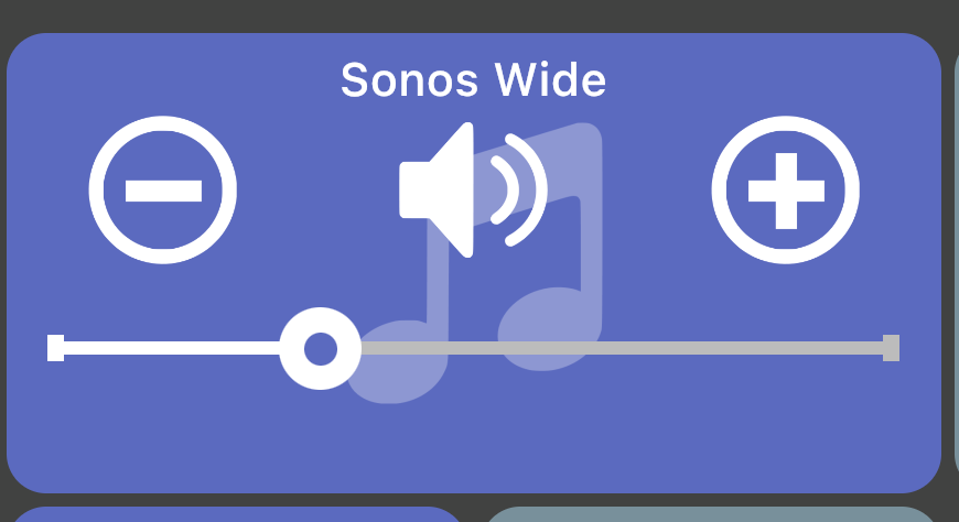

@jpage4500 Checking in to see if restoring volume controls for devices of type "Speaker" is still on your radar, thanks!
Marc
I still have the Hub Informational Driver installed so I went and looked to see what it provides. I didn't think it did any kind of polling but I'm not looking at the code - just the preferences page (scheduled jobs).
I will say there was a couple of other things it had which I wanted to handle in Android (I might even support it in Android HD+ I'll have to look).. but things like sunrise and sunset. Also it has commands to restart the hub.. Anyway, let me know.. I can handle it and show it as a date
I didn't realize it wasn't there. I see one on my test devices screen (login with "0.0.0.0" to see this). You might have to make the tile larger than 1x1 to see it though

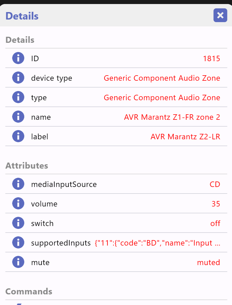

Adding this clarification to my original post: Below when I say 'my devices of type "speaker" ', I am refering to the "Device Type" that one configures in HD+. The device type in Hubitat is what the screenshot shows below.
Upsized if from 4w x 1h to 4x4. Volume control not showing up on my devices of type "speaker" with HD+ on windows; it does show up on the original Android HD+ app. Screenshot below shows the device details, in case that is helpful.

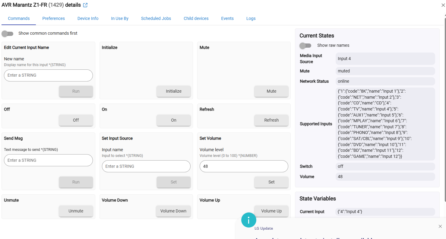

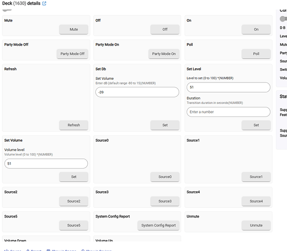

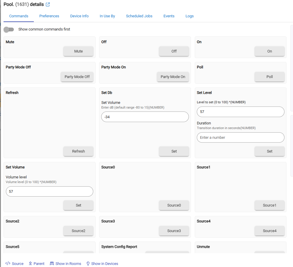

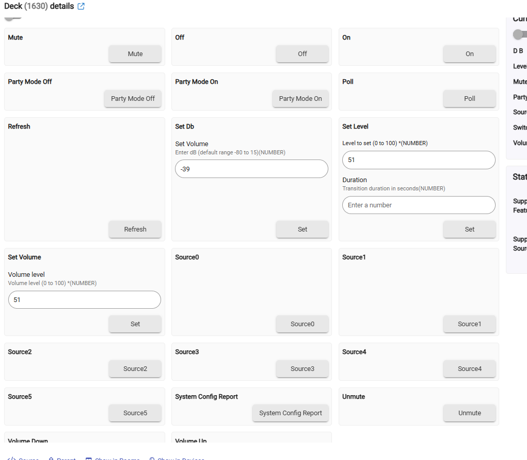

Can you check something for me? Check if this device has either a setVolume or setLevel command. One of those are required for the volume slider to show up. I already see the volume attribute so that looks good.
That's the only thing I can see which might prevent it from showing up. If not there - does this device support another way to set the volume?
2 devices, 2 zones each. They all support "Set volume". Only the Yamha seems to support "Set Level".
Screenshots below.
Let me know if you need anything else and thanks for digging into this!
Marc
marc
Oops.. my mistake. I forgot there's 2 different device types that show controls like this - music player and speaker. Only the music player type was showing any controls. Simple fix that'll be in the next version

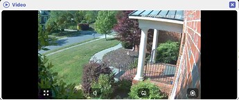

Hi Joe - just updated on TestFlight. A few observations on RTSP for my cameras:
-Hidden video controls working
-Now when clicking video tile to full screen, it’s correctly retaining the landscape aspect ratio of the camera on the portrait screen
  • If I set the video options to ‘fit’ it doesn’t seem to affect the tile view (it’s a little cropped) However the full screen view whether the phone is in portrait or landscape orientation are perfect with the full image visible.
  • Previous issue of the video in full screen stopping when phone was rotated to landscape and back seems to be resolved.
Great work :+1:t2:

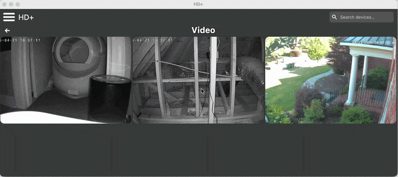

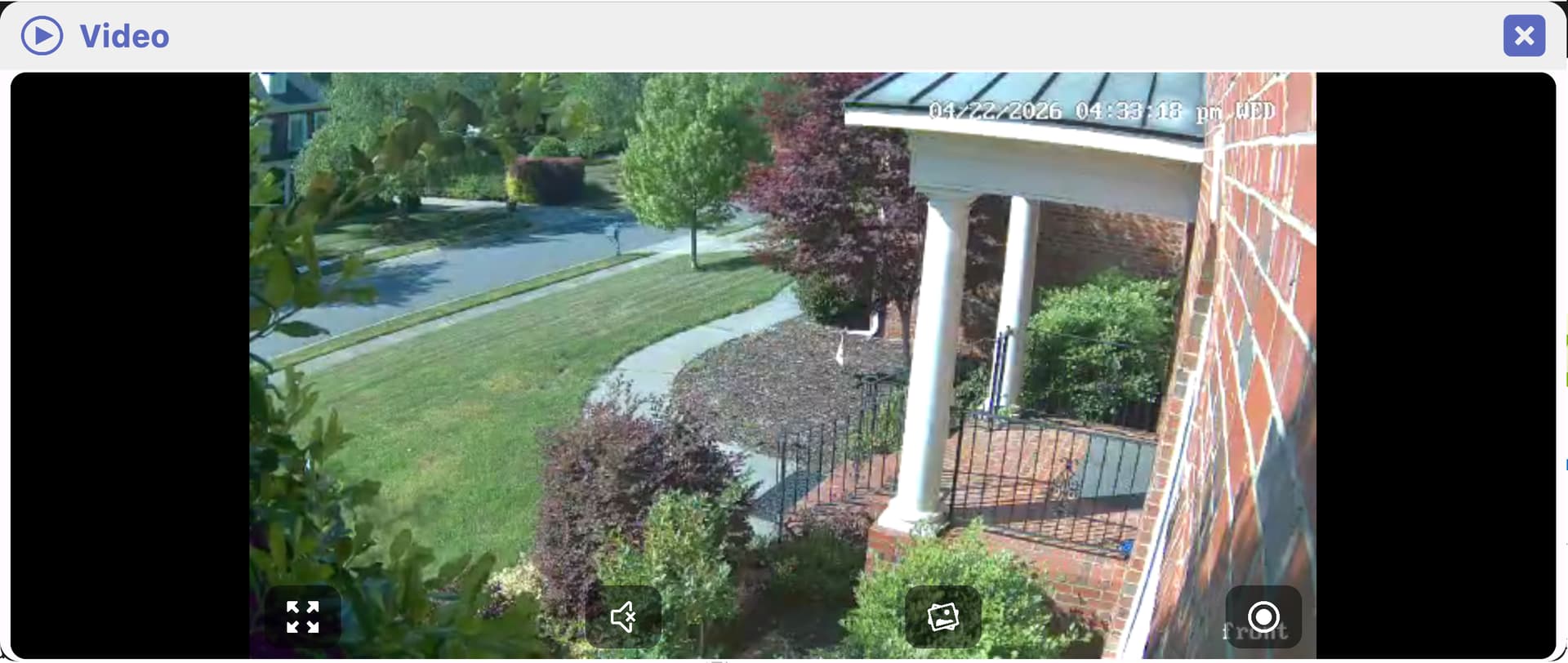

Here's a preview of what I'm working on now
  • opening a video full-screen will re-use the existing connection so it'll display instantly and not take 5-10 seconds to re-connect to the RTSP stream
  • video controls: snapshot, record, mute
Here's what it looks like on Mac
hd-video-desktop

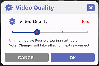

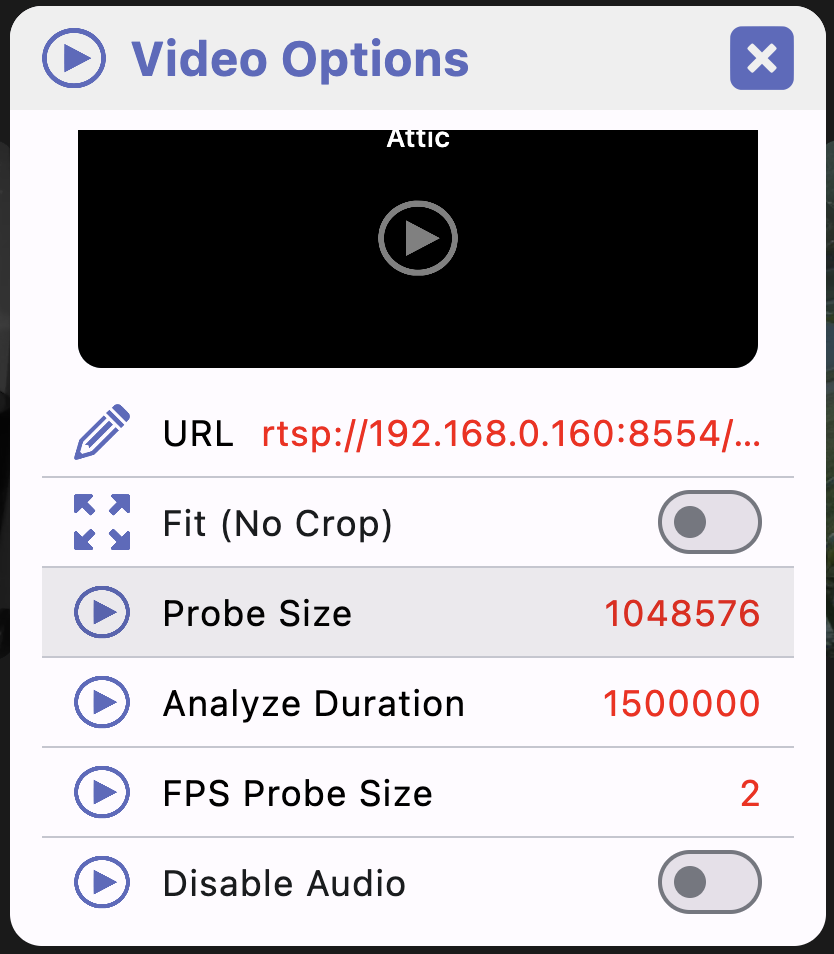

I also added several new video settings -- low level stuff. I'll try to explain each one but bottom line there will be a lot more flexibility if you want to tweak anything. Hopefully the defaults will work for most people though

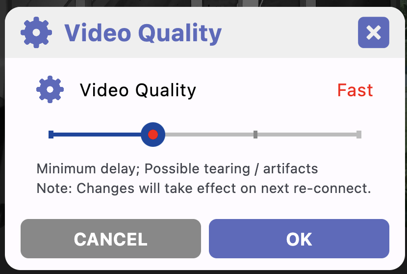

I'm realizing a lot of people use live video feeds on their dashboards. So, I want to try and improve handling of video tiles more so than was ever done on the Android client.. including re-using a connection when viewing the tile full-screen (instant). I also figured if you're viewing a live feed you might want to take a snapshot or recording of that feed so I added buttons for this too. I have a gif showing this above and some screenshots below
Rather than expose every FFMPEG option I combined them into a quality slider.. the default value should work but this at least lets you tweak the settings since 1 might work better on some cameras than others.

Thank you! My volume controls are back!
