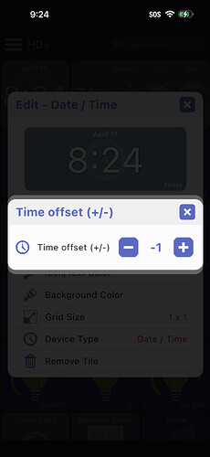

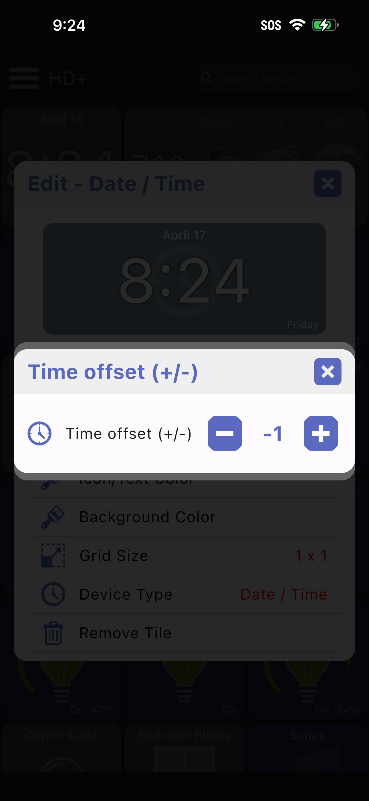

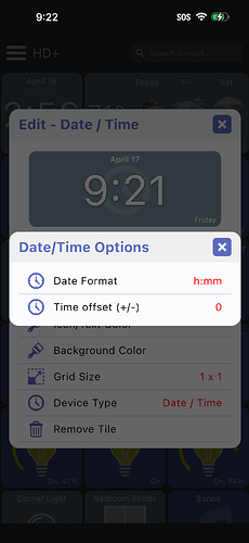

A feature request for consideration. I haven't tried yet but I'm guessing that the Time/Date tile uses the phones local time? I wonder if there's any possibility of locking it to a time zone to match the hub.
Use case - My tablets are wall mounted so the time date tile is just used as another clock. However when I'm on holiday, viewing a dashboard of my devices at home, the time at home is more relevant. While abroad on holiday I often look at a dashboard on my phone to see if automations have correctly worked (curtains opened/closed, lights off/on).
I remember looking into this a while back for the Android version. I don't get the Hub timezone via MakerAPI so I'd need some device where I could get it (like Hub Information driver)
What I ended up with is just an option to offset (+/-) the current time
