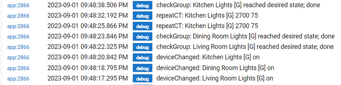

And the result:

From the screenshot, I can see that a Maximum number of retries can be set (shows 20). So it looks like you will be able to control this, along with the delay between retries.
