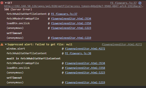

Can't seem to reproduce that. I think you said before your on Windows, if so hold down the 'fn' key and hit 'F12'. This should open the console, right click in there and copy console. Paste it back here if you would. Thanks

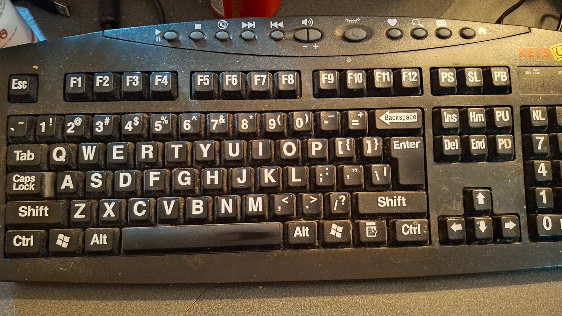

Windows keyboard? Bottom row: <ctrl> <fn> <win> <alt> <spacebar> ...

Weird, try just hitting the F12 key and see what happens, lol
right-click over any brown section and copy
flowengineeditor.html:2725 Attaching undo/redo event listeners to real editor
/apps/api/820/getFile?access_token=44bd24e7-9948-4847-afc4-19118aca787c&name=FE_flowModes.json:1
       Failed to load resource: the server responded with a status of 500 (Server Error)
flowengineeditor.html:4272 Suppressed alert: Failed to get file: null
window.alert @ flowengineeditor.html:4272
favicon.ico:1
       GET http://192.168.50.126/favicon.ico 404 (Not Found)

Do me a favor, make sure you have the latest available by doing a repair. Then go into the one app and click 'done'. Then back to the Editor and see what happens!
