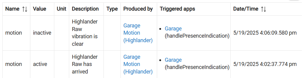

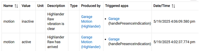

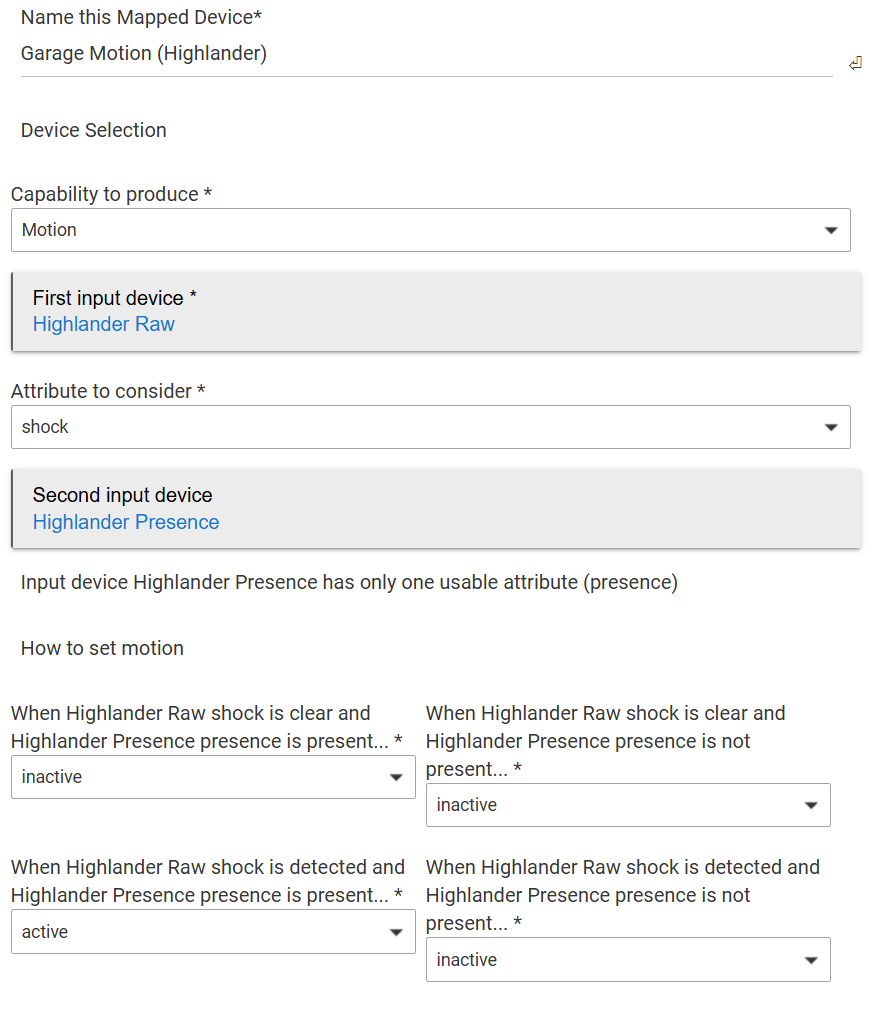

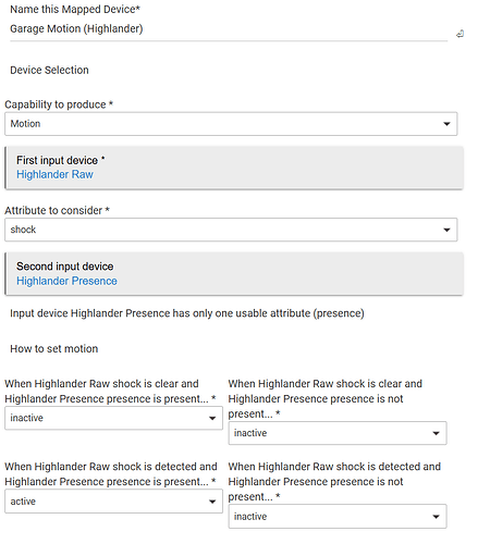

New feature added. In addition to the simple form already supported, where one capability is extracted from a device that already supports that capability, this now also permits a Mapped Device. On a Mapped Device, the output can be different than the input and can vary with two source devices.
For example:
This allows me to a) turn a shock sensor into a motion sensor, and b) ignore the shock sensor when the car isn't at home to report that it has gone idle.
This could always be achieved with a rule in Rule Machine, but random virtual devices with dedicated Rules to control them are somewhat annoying. This keeps the virtual devices collected under a parent and the rules to manage them in a separate place from actual automation rules.
Currently this only supports input and output properties that are enums; I plan to add support for numbers and strings soon. In the meantime, enums cover a lot of use cases, so it seemed worth publishing as-is.
