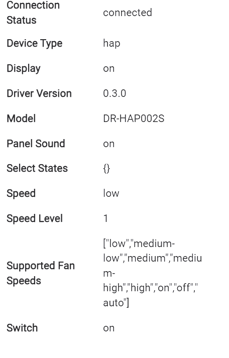

@classic-dave I'm thinking that air purifier should likely have it's own driver as the only commands that appear to work are on and off and speed setting. The preset modes don't do anything along with the other fan specific stuff (expected).

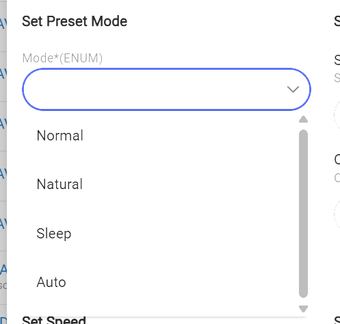

the driver seems to have found the correct preset modes:
However, the settings options are incorrect:
When I try to change the preset mode it doesn't work, the device does beep (received a command) but it doesn't change the preset.
And yes from a UI simplicity sense, it would seem not having the extra setting that don't apply would be less confusing
