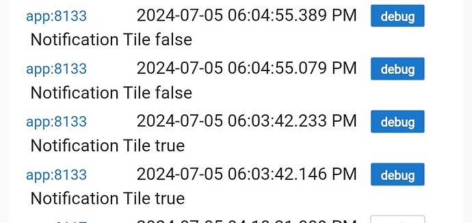

Ran it twice, once true and once false. Names are Buffet and Restart.log

if(("${it.name}" == "Restart-log" && !res) || (" ${it.name " != "Restart-log" && res))
"${it.name}" returns Notification Tile. Explains the no matching
notifyDevice[0] returns 1st list name [1] returns the second
i think there must be hidden characters in name.
