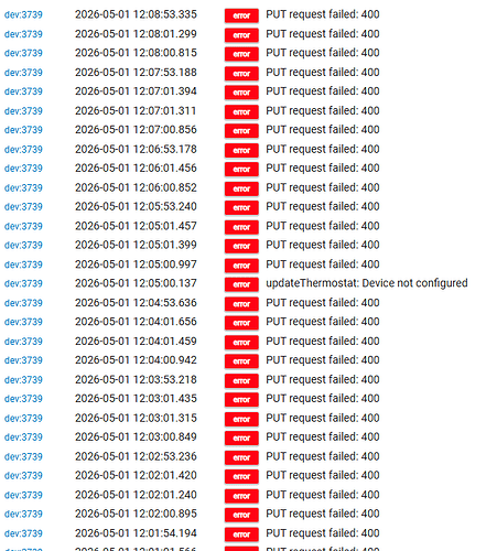

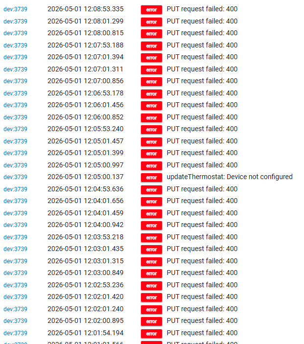

The credentials do not survive a reboot of the HE hub, and I have to re-enter them after the re-boot.
If I do not, I constantly get the following:
Is there a way to make the credentials "stick"?
All the data IS in the State Variables, but don't get passed to the authorization.
I just copy/paste the values in the state variables "list" into the "save credentials" fields and "run" and it solves the problem,
BUT why do I even have to do this after a reboot?
Thanks!

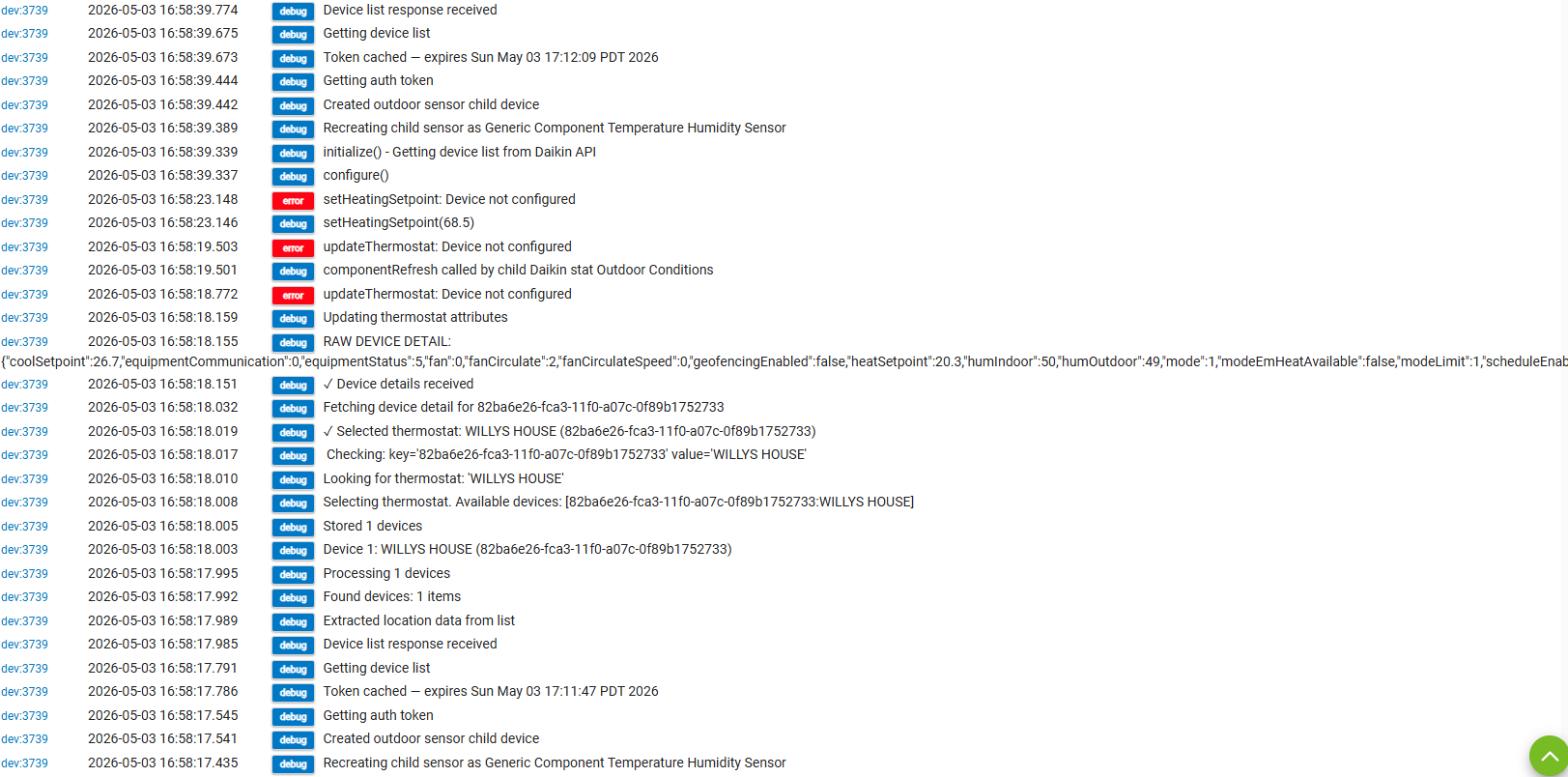

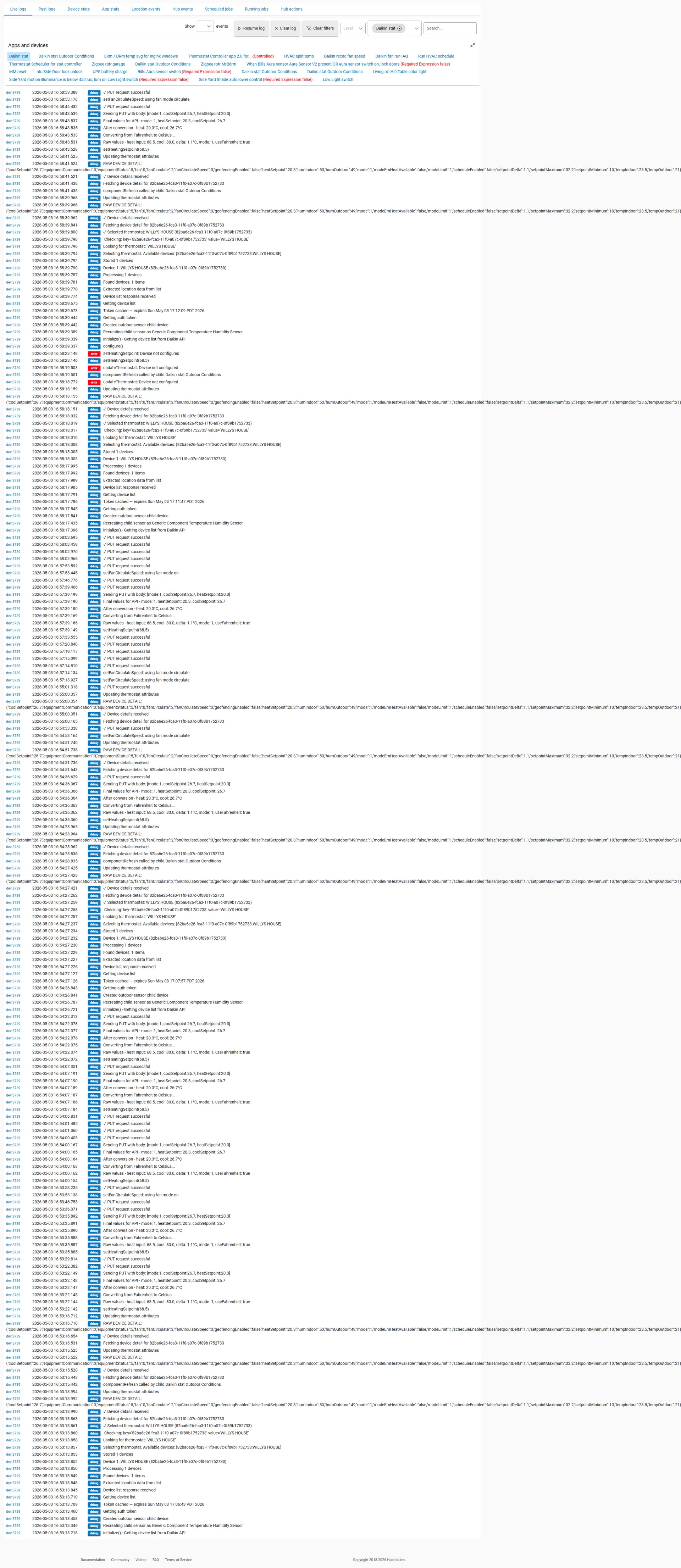

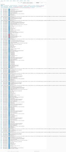

Here is my debug log just before a reboot, then after a reboot (at 16:55:00)
This is a partial screencap of the error time and initialize time:
Then at 16:58:18, on the device page, I clicked on "Initialize" and the errors started popping up
Then at 16:58:39, I clicked on "configure" and the errors stopped and the stat started working again!
SOOOOO...
I must have clicked on "Initialize" while on the device page (for some reason) and it messed me up!
I tried it again, and clicking on initialize messes things up and clicking on configure restores order and the errors stop!
What is the difference between initialize and configure, and why would the driver start to fail when initialize is clicked?
Thanks for the driver!!!! It has been working great!
