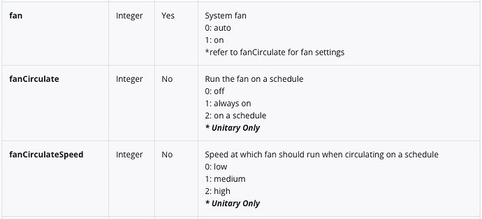

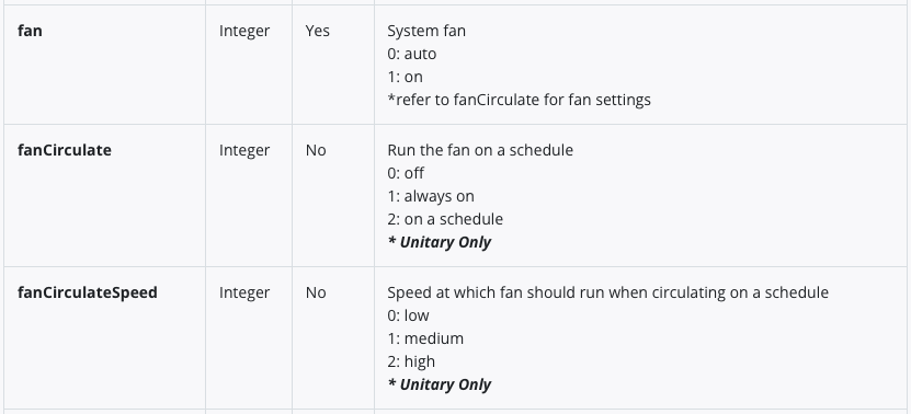

More notes on the fan mode/speed testing topic...
The Daikin One Open API documentation defines the related parameters in the "Get Thermostat Information" endpoint:
Observing the response to this endpoint after cycling through all the " Update Thermostat Fan Settings" endpoint command combinations, it appears that the property fan never changes. So the Hubitat thermostat device fan mode maps to the Daikin fanCirculate property as follows:
Hubitat        Daikin
   on          1: always on
  auto         0: off
circulate      2: on a schedule
Fan speed is independent of the above, and as @user3639 states is not a declared attribute of a Hubitat Thermostat device.
Frankly, I don't understand what the "fan" mode is supposed to represent in contrast to "fanCirculate". That's a lot of what's tripping me up. I think what I'm going to do is map Daikin's "fanCirculate" to Hubitat's "thermostatFanMode".
I'll expose the fan separately as an extra attribute, even if I don't understand what it is.
And then I'll expose another extra attribute for fanCirculateSpeed.
Oh, maybe this is what it's all about... I just noticed that the Daikin "fan" attribute is available on all systems, while "fanCirculate" is unitary only. So if you have a mini split or something you would set fan "on" to have the blower on even when it's not heating or cooling. I'm guessing if you have a Unitary system "fanCirculate: always on" is probably identical to "fan: on".
But I'll expose both and hopefully we can get a few datapoints about how our systems behave.
