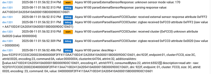

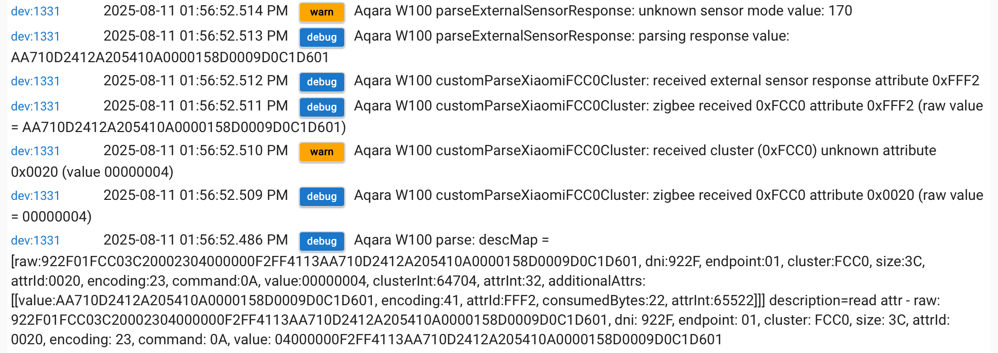

That's very interesting… I was sniffing the W100 communication to Aqara M3 hub and I am 100% sure it was the hub pushing the data! … but now I realize that because I was filtering the WireShark to show only the W100 comm (I have many other devices paired to the M3), I have actually missed anything coming from the ‘paired’ in Aqara Home external sensor.
Any idea what’s an FCCO attribute 0X0020 , value of 4 is?
Or FFF2 attribute, value 170
Sorry, no.
Those appear to be the data.
Given my lack of knowledge and tools, I’m “shooting in the dark “. :flushed:

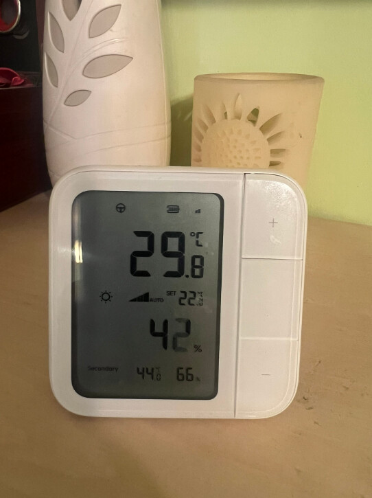

I didn’t care for the aesthetically displeasing display with numbers pushed to the right and tiny secondary display.
I returned it.
I also find the design to be quite unusual and not very appealing, to say the least... My wife has not seen it yet, as it is still sitting on my desk.
Update: It looks a bit better now with the HVAC controls enabled.

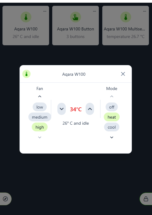

I have pushed the dev. branch version ver. 1.2.1 2025-08-14
There are still a lot of details to be cleaned up, but the thermostat control functions are working
BTW, is there an existing bi-directional thermostats syncing app?
When a physical thermostat settings are changed (heating setpoint, heating mode, fan mode, etc,,) -> it should update the virtual thermostat attribites (the Aqara W100 virtual thermostat).
When the virtual thermostat settings are changed -> it should update the real thermostat.

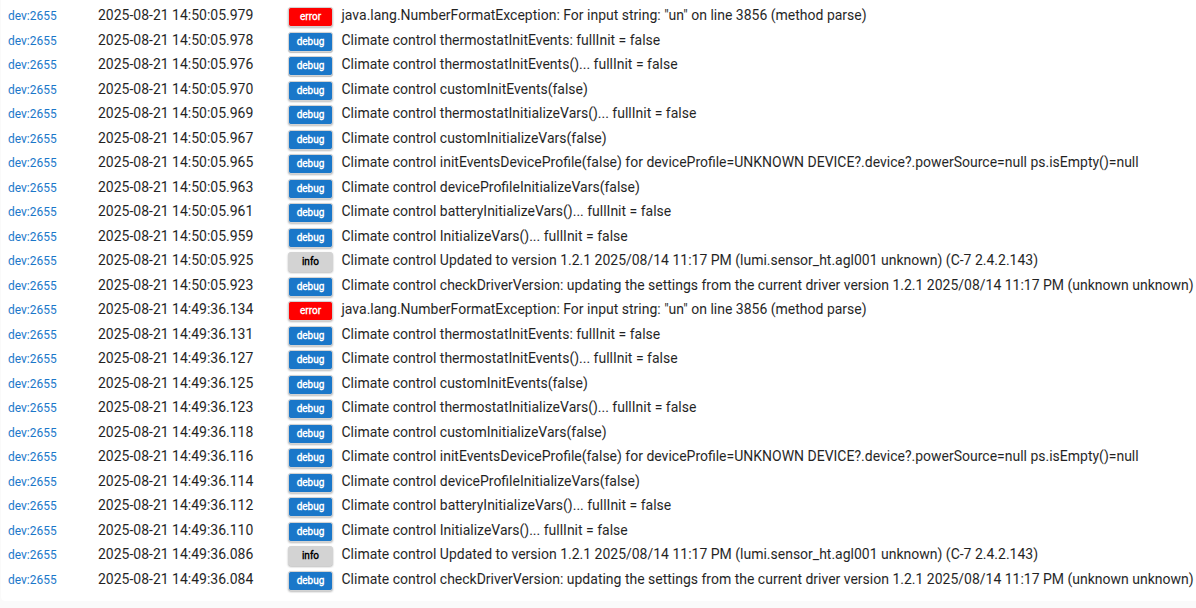

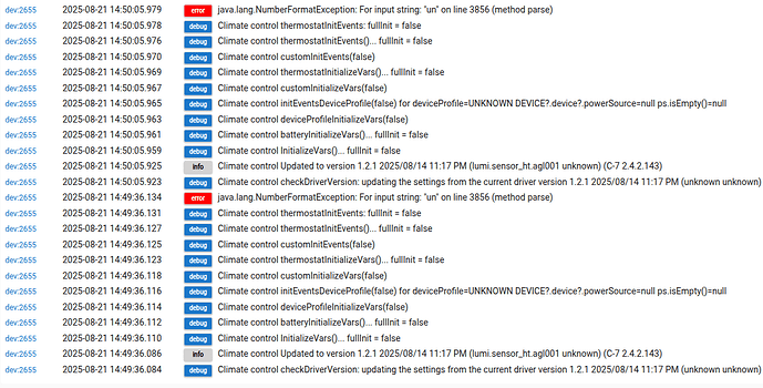

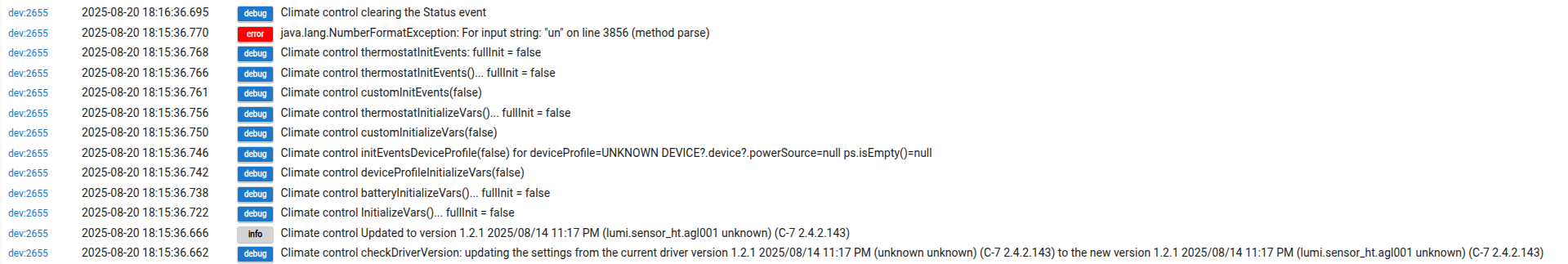

I finally got to try your driver. Everything is working fine except the buttons in HVAC mode dont do anything. They make the middle line flash for a few seconds but no change occurs. It generate an error in the log:
@ymerj do you get this exception any time you press a button in HVAC mode, or it was just once? Even with the Device Data completely wiped out, I can not reproduce the error in your logs..
When the device is in HVAC mode, pressing any of the three buttons will activate the thermostat programming mode for W100. For one second, all symbols on the middle line will start flashing, indicating that W100 is waiting for confirmation from the driver. Once the confirmation is successfully received, only one symbol should flash—typically, the "set" text. You can adjust the temperature setpoint by pressing the upper and down buttons. Pressing the middle button again will make the thermostat mode symbol flash.
The middle line flashing for more than a second indicates that W100 has not received confirmation from the driver for some reason...
I get this from any button press in HVAC mode: The entire line flash for 10 seconds and no change occurs.
I get the same error if I save preferences and get 5 times these if I disable HVAC mode. Same error for button press with HVAC mode disable.
Setting the mode or the temperature from the driver works but give the same error in the logs. Basically anything I do generate this error. The device works from the driver page but not from the buttons.
Bypassing the updateAqaraVersion() method clear the error and makes the device work from the buttons.
