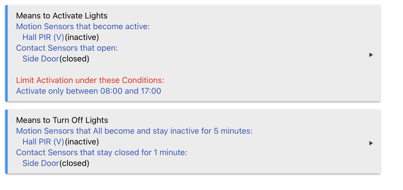

It could be better to do this in Room Lighting rather than Rule Machine. Something like this:
It may need tweaking. I guess that the door closing after entry may briefly turn the light off if the motion sensor isn't already active at the moment but it should work.
Edited: The 1 minute on the side door closing added as it's expected the motion sensor will trigger again before the minute expires. TBH you could probably just do away with the door contact turning off the light as the motion inactive will do it anyway.
