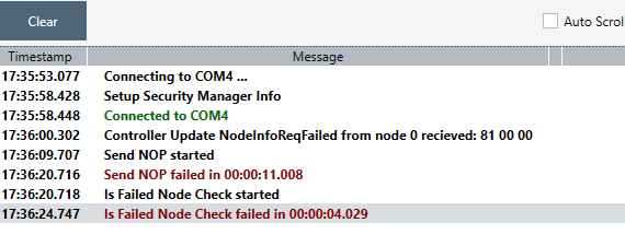

Tried that as well, looks like the Is Failed/NOP checks are both failing, but the device isn't showing up in red. PC Controller logs
pc_logs

In your screenshot, why does it say node 0? Did you actually have a node selected?

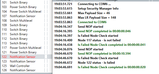

What version of PC Controller do you have? Your logs look different than mine.
v5.54.103 (going to check for updates right now)
I appreciate you doing that check! I'm also on 5.54.103 I'm not sure what that Node 0 was from, but yeah I had device 31 selected. I'll try bringing the PC Controller off-site and see if there's any luck removing away from all the devices.
I just noticed yours is saying sending the NOP is failing, where mine says it completed. Maybe the stick is not even properly paired to the hub?
