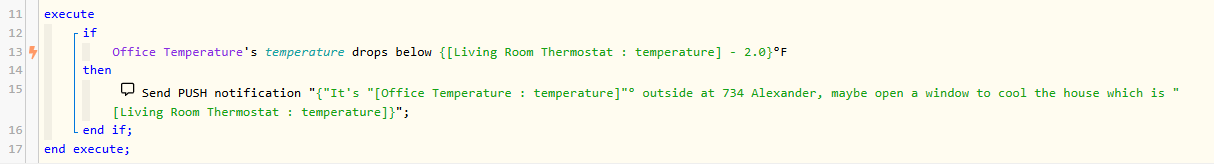

This post just reminds me how much easier things like this are with Webcore. I used a few of my existing devices to demonstrate, with a thermostat and a temp sensor.
Just pointing that out, I don't expect you to use it instead.
