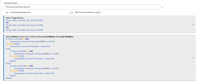

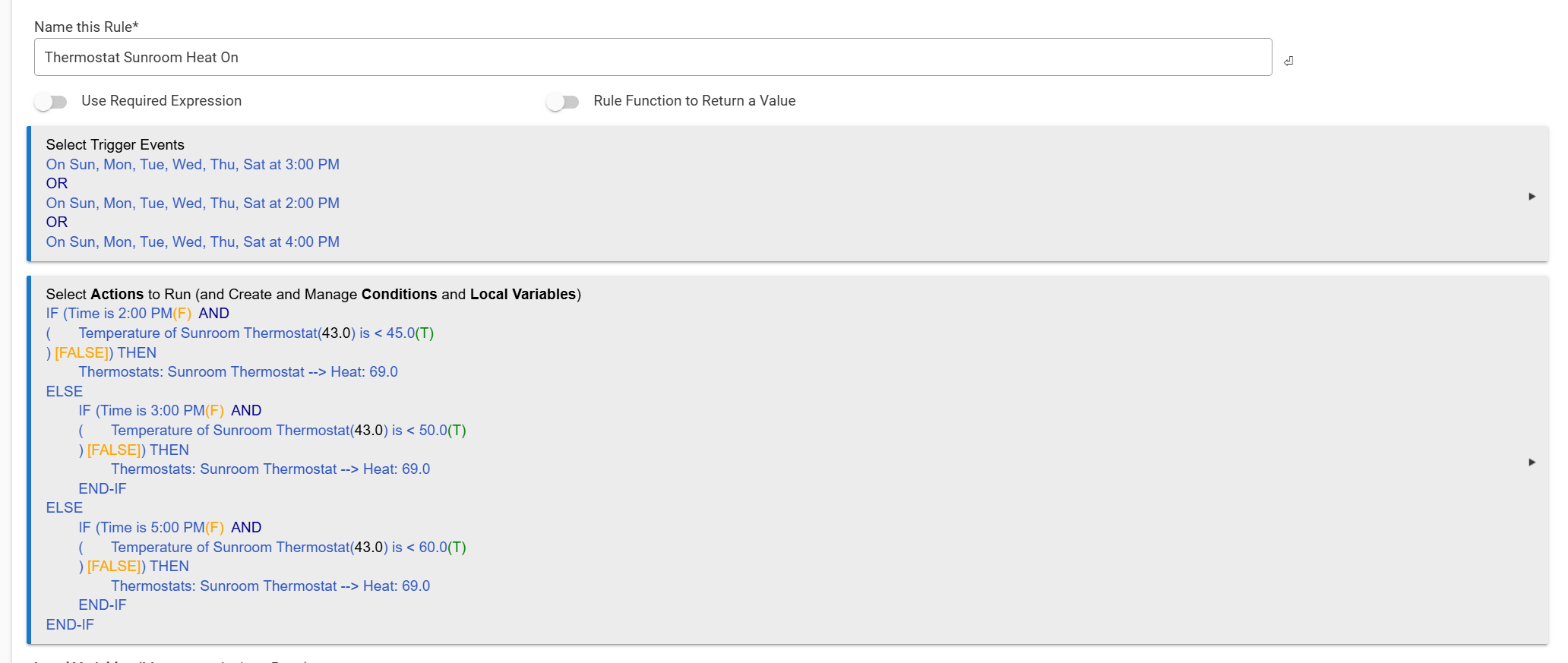

This is what I ended up with for a trigger and action. I just finished it, so today will be the first test of the rule.
I wish there was a way to reorder triggers like you can with actions and conditions, the times not being sequential is bothering my OCD.

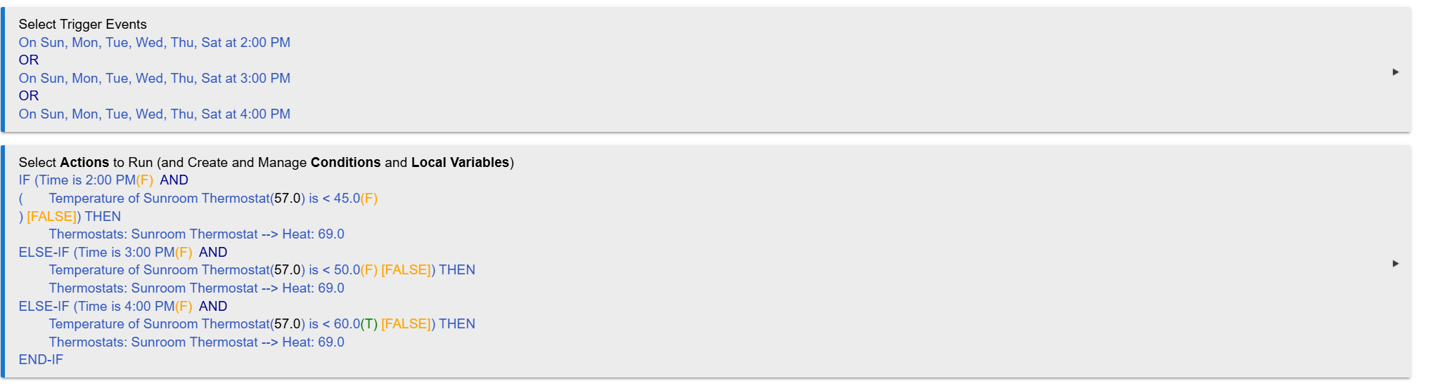

Instead of having multiple Ā« ELSE Ā» followed by an Ā« IF… END-IF Ā», you should have Ā« ELSE-IF »’s.
As far as I’m aware, you can only have one Ā« ELSE Ā» statement, but as many Ā« ELSE-IF »’s as you want.
So the current rule might not be able to pick-up the 2nd Ā« ELSE Ā» (for 5pm).
I changed the logic to the below, I also had a time mismatch (5pm vs 4pm) in the trigger vs conditional action which I corrected.

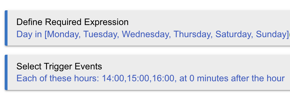

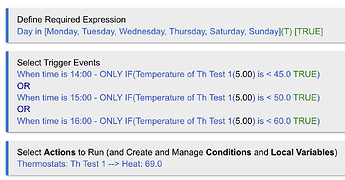

You could set up a required expression to restrict the triggers to certain days using a "Days of week" condition, and trigger on the specific times using a "Periodic Schedule", like so:

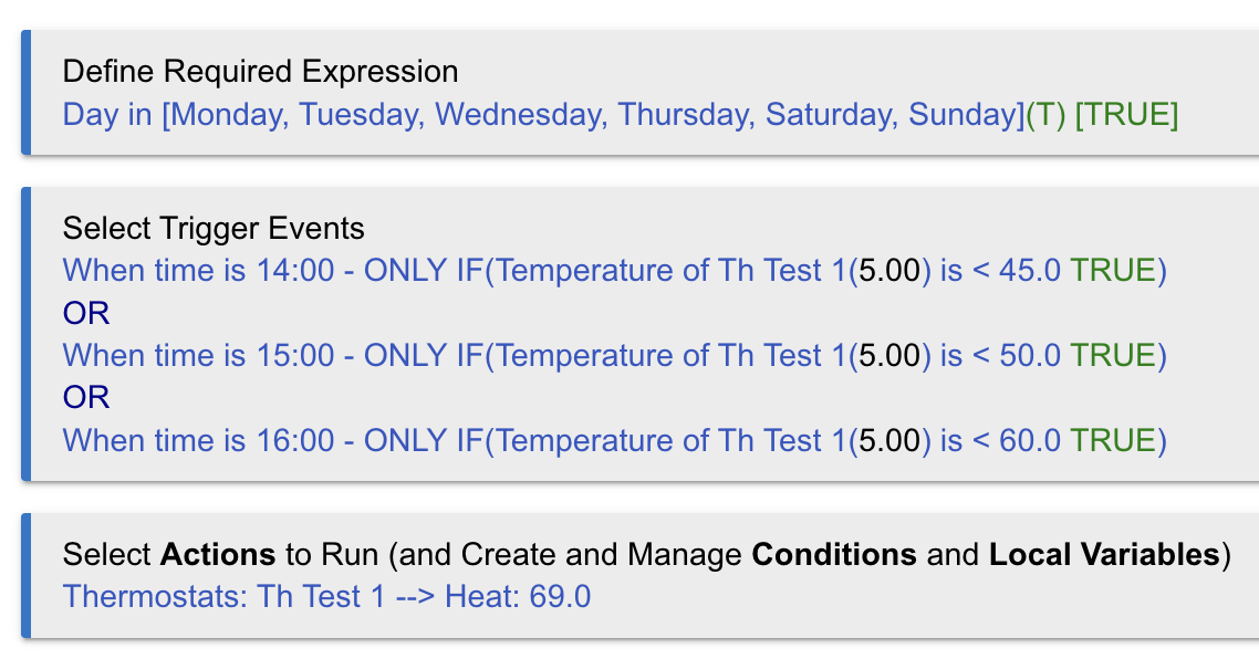

An alternative would be to use conditional triggers, like so:
