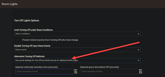

When you create your RL instance, select the "Setup Lighting Periods..." option. This initially allows you to define different on states based on either Hub Modes or Time of Day.
Back on the main screen, if you then drill into the Turning Off settings, you will see Alternate Turning Off Methods. Here you can choose Use Preset Setting for Turn Off Per Mode, with the per mode option being the important part.
Then when you go back to the Periods section from main screen, you will not only see settings for ON state per mode, but also preset OFF states for each mode:
