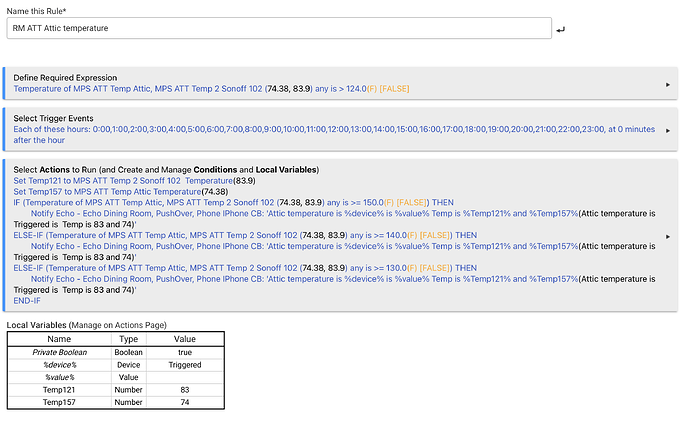

I want to create a rule that monitors two temperature sensors in my attic. If either sensor rises above 120, 130, 140 and 150 degrees F, I want to get a notification at each threshold.
What's the best / most efficient way to create this rule?
This is what I came up with do far. Suggestions to improve?
What you made wont do what you are asking for, and all those elseif statements are redundant, since the first one is the lowest temp it will trigger first for all the cases, and the message output is the same.
So do you want it to specifically trigger at those thresholds you pointed out, or do you want it to just trigger for anything above 120?
Do you want it to trigger hourly, or any time the temp hits the target?
ah good points.
I didn't want to use temp as a trigger as that didn't work properly last time I tried to do it with my pool pump. So I thought "grab current temp once every hour" and then if it's above 120 send msg, if it's above 130 send msg and so on.
I want it to trigger at 120 (temp now above 120) and then if it rises above 130 trigger again, send 2nd notification (temp now above 130), at 140 snd 3rd notification(temp now above 140).
You would want to set your trigger to be the 120 mark then.
