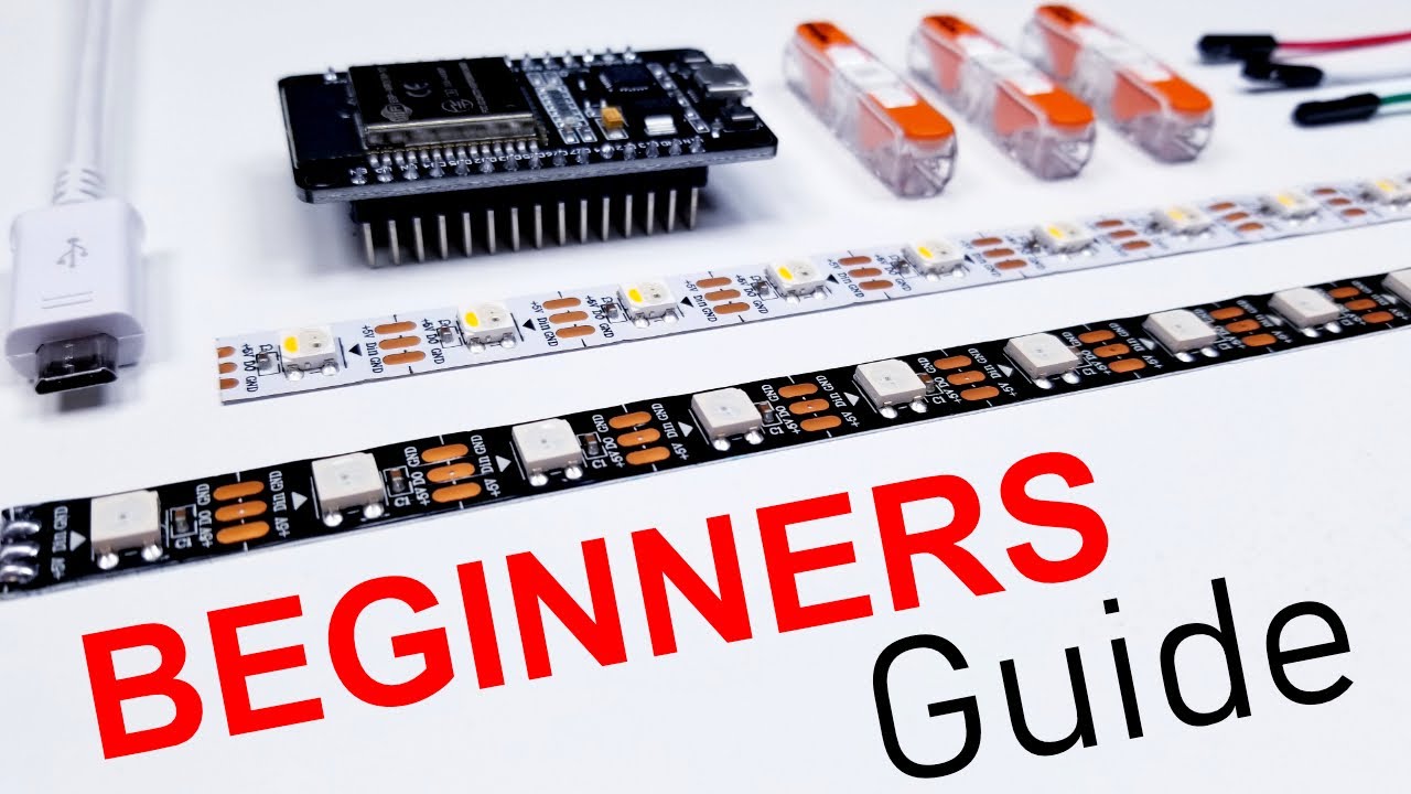

If willing to DIY, a $5 ESP32 board installed with WLED, a small 5v power supply with 2-3 amps, 3ft of LEDs, 3ft diffuser channel and some soldering skills or use of wiring clips and you are there for each section. :grin:
The ESP32 board relies on WiFi but remain local except for firmware updates. The nice thing about WLED is that the six separate controllers can be sync'd to act as one.
There is a WLED community integration with Hubitat.
