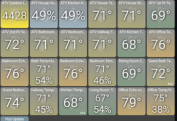

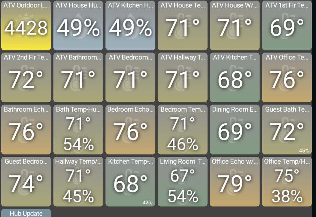

In the zigbee world I'm really impressed with the thirdreality unit the most. The AVT units pictured are an averaging driver I wrote for rooms with multiple devices so ignore those.
I've got 14 physical devices - all devices can report to 2 digits of precision. I choose not to display it, but I do calc on it in my averages.

The temp sensor in gen 4-5 Echo's - at first I thought it was garbage - I realized it's skewed by the ambient heat of the unit, so it's reporting was 2-3 degrees higher at all times. No battery needed there but not native to HE (I bring it in via HA).
Do have a reference device! It's hard to take at face value what any sensor reports until you get validation. I know my freezer temp detector and fridge temp both were way off. (not pictured). Again the 3rd reality units held well at extremes.
