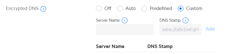

Regarding setup via the UI GUI, the only Encrypted DNS setting I see is choosing nextDNS from the list of preconfigured encrypted DNS providers.
What I don't get is how to to connect that setting in the UI GUI to my nextDNS account/profile. Do I need to enter the DNS-over-HTTPS endpoint from my nextDNS account in the DNS Server list under my primary WAN? Currently have that set to Auto:

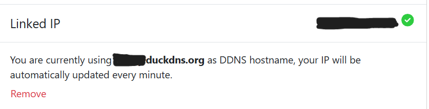

Also have DDNS via DuckDNS set up on my primary WAN so I connected things to nextDNS via DDNS on the nextDNS site, but not sure if that's the best way to do it...
That gets me here on my phone and laptop, but still need to connect the profile...

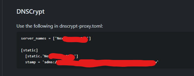

No. You choose Custom under the Encrypted DNS setting and set it to your NextDNS Server Name and DNS Stamp.
You can find your Server Name and DNS Stamp under DNSCrypt under the Linux section of the Setup Guide page in NextDNS.

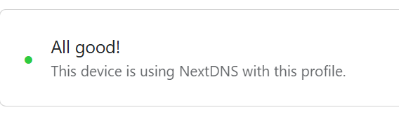

Hah!! Victory...owe you a beer.

I think now I get it:
  • Predefined: No nextDNS account connectivity, just using nextDNS servers
  • Custom: nextDNS Account connected
I had assumed that the "Predefined" option would include "...and here's where you put your account info!" much like the Dynamic DNS settings in the UnifiOS. But no... :slight_smile:
Not necessarialy. On the NextDNS web site on the Setup tab:
Set the address of your router and all incoming DNS requests from that address will use your account. But this would not be the preferred method of connecting to your NextDNS account. Either the custom setting, or using the CLI would be better. Then it's not dependent upon your IP address, which of course could change unless you have a static IP from your ISP.
Thanks, interesting. I did actually enable the Linked IP address setting (along w/my DuckDNS settings to keep the external IP address updated) in the nextDNS settings before I added the DNSCrypt settings to the Unifi Network app, and my devices were still not reporting they were using my profile.
After adding the DNSCrypt settings in Unifi, my devices all reported using my nextDNS profile.
