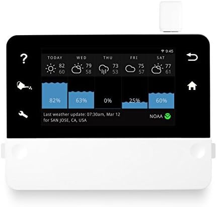

I have Rain Machine. It has been flawless ever since I installed it five years ago. There is an integration for it that makes it easy to use.
The box runs a version of Android and allows control at the unit, or via Wi-Fi, and via the HE community integration. I have no comparison to other options as Rain Machine is the only one I've owned. Below is what I have...they also have a 16-station version, and smaller options as well.
I put mine in an outdoor box to keep it clean and dry.
