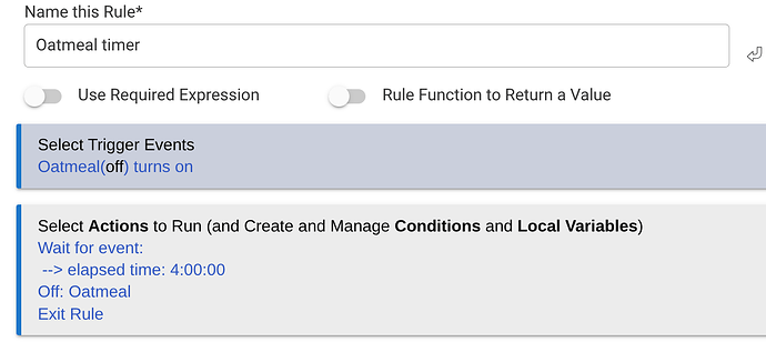

We do something similar with a mini crockpot. The plug stays attached to the appliance. I actually use a WiFi plug for the oatmeal timer because unplugging it does not affect the ZigBee mesh. Kasa Smart Plug Ultra Mini 15A, Smart Home Wi-Fi Outlet Works with Alexa, Google Home & IFTTT, No Hub Required, UL Certified, 2.4G WiFi Only, 1-Pack(EP10), White - Amazon.com

I know you use webCoRE, but here's what I use in Rule Machine to control the outlet.
I'll use anything that will help protect my house from burning down! :slight_smile: I do also like working with RM and Basic Rules, so your help is appreciated.

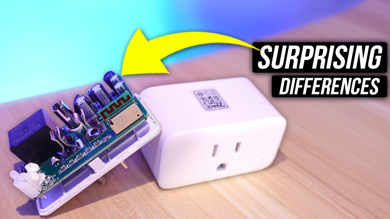

I just watched a YouTube video about smart plugs with Third Reality claiming to have zero crossing switching. Given it uses mechanical switching contacts (relay) I am a bit suspicious of zero crossing effectiveness (maybe they engage relay coil a couple msec before zero to allow contacts to close??) but if they went to that trouble presumably it has some value. Zero crossing was more typically for Triac switching. I thought it was a clever idea for a relay output though.
Also I would derate by 80% when using these plugs. So 1440-1500W watt max for a 15A plug. Just to be on cautious side of things.

Just as a backup to the device parameter, I also wrote a Basic Rule that if the Zooz turns on and stays on for 31 minutes, then turn it off.
