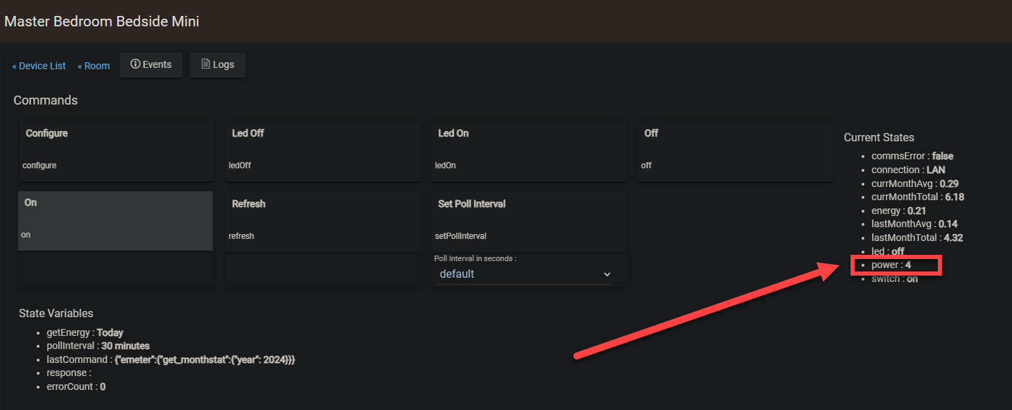

Yes that is what I want, but I don’t see the Watts variable in Hubitat to use as a trigger…
You should see something like this in the Device Details page for your plug in Hubitat. The power reading will be the number of watts it is currently drawing, i.e. 4 watts in this example. Note, I am still using the Community developed drivers, but I would expect the built-in one's to be almost identical.

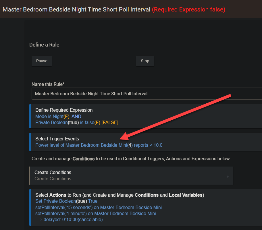

When you go to use it in a rule, you may want to use something like this to check the power reading:

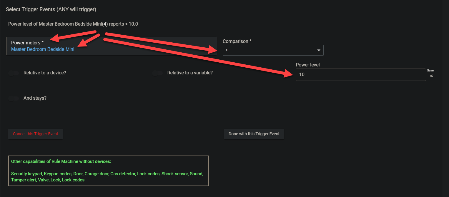

To do this, click on the Trigger Events, select Power meter, select your Kasa device from the list, Set the type of comparison to do and the value to compare to.
