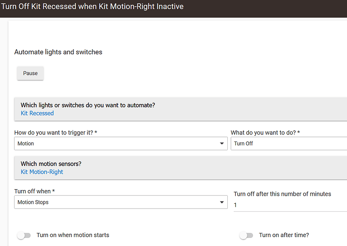

Ok, in the interest of keeping it simple, :slight_smile: , how about just turn the light off an hour after no motion is detected? This seems to work for me in a 1 minute test. And, it's simple.

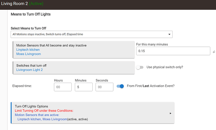

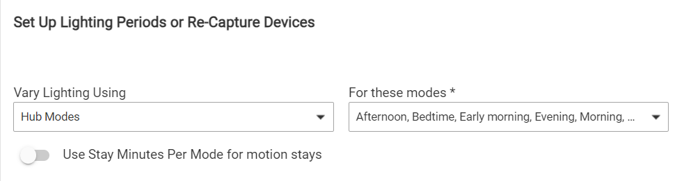

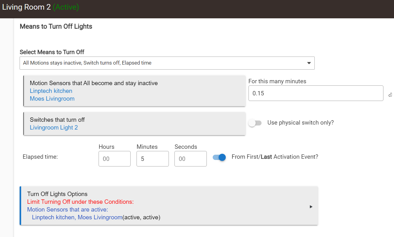

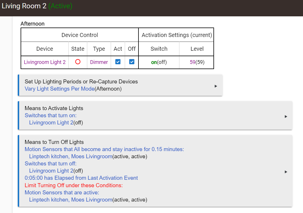

This works for me; you need to select the option "switches that turn on/off" under means to activate and turn off. And select motion sensors that become inactive under means to turn off.
Thanks, I will try this today

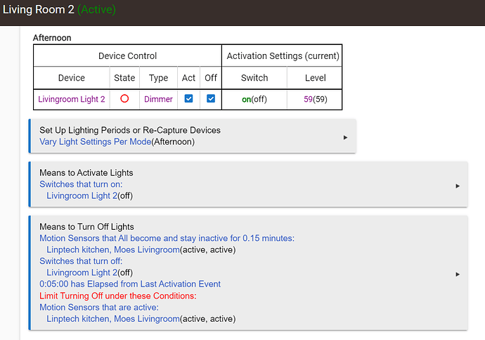

What is the purpose of the 0.15 mins in your example, and how is it different in purpose from the "5:00 has elapsed from last activation event"? Also, can you share screenshot pls how you were able to set the "0.15 mins" I am not able to find that option.

The 0.15 mins motion inactive is the same as your "stay: 60 mins".

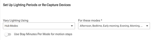

Note: If you disable "use stay minutes per mode for motion stays" then you will see the option I've used.

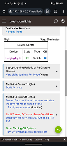

The purpose of using 5 mins elapsed since last activation event" is a contingency for any unknown issues where is the switch has been operated by various means but failed to switch off upon motion inactive. This has worked for these random issues for me which I experienced in the past, may not be required now.

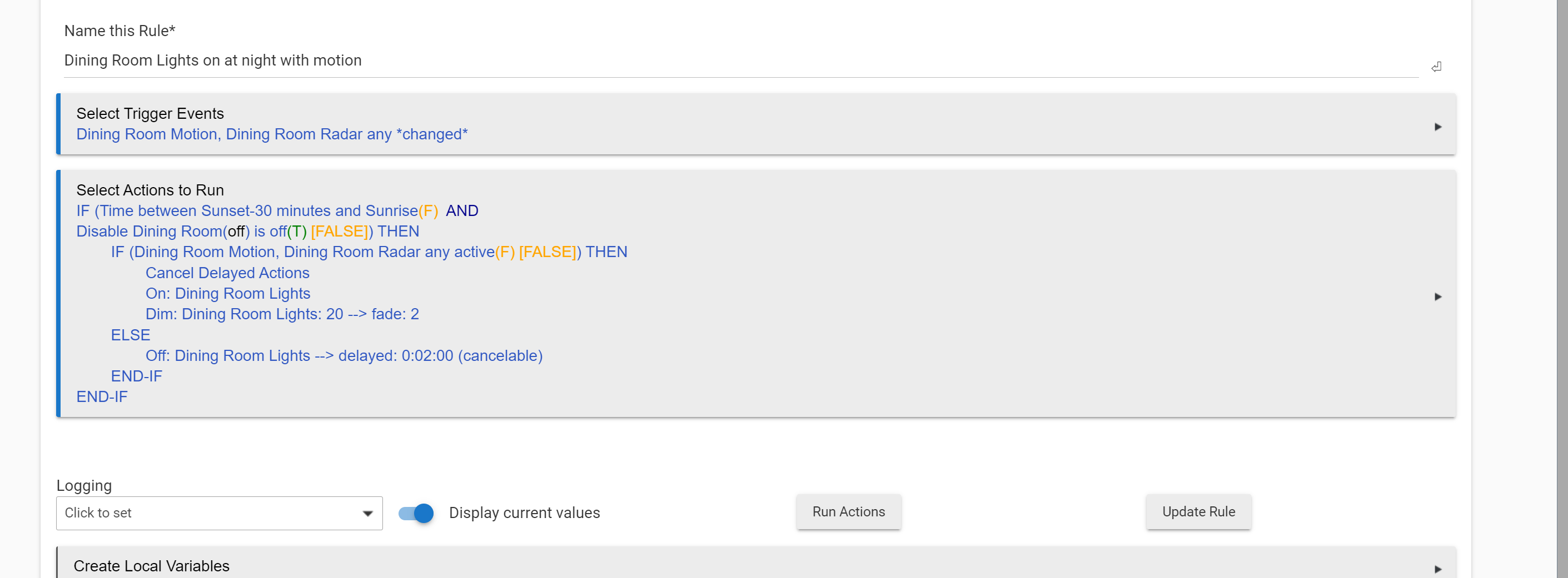

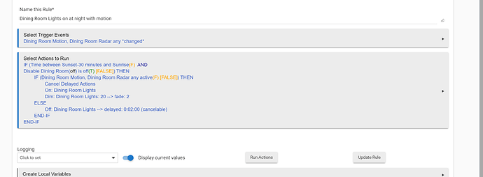

this is my rule.. and one of the 2 sensors is a true radar sensor that stays motion active as long as you are in the room,
it works in conjunction with other rules that set a virtual switch on.off whenever a physical switch is turned on/off, to signify to bypass the rule and leave lights on in the room till you turn it off..
as i said there and many variations and ways to do this depending on exactly what you want.. i have another rule that just turns on from door lights and turns off x minutes later no matter what..

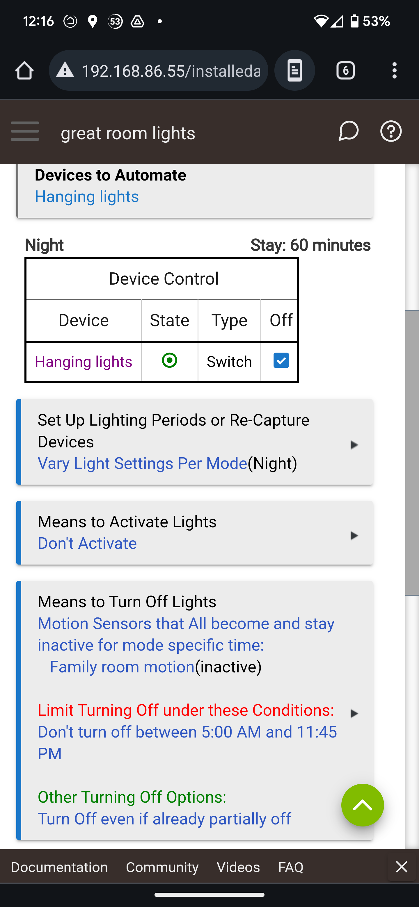

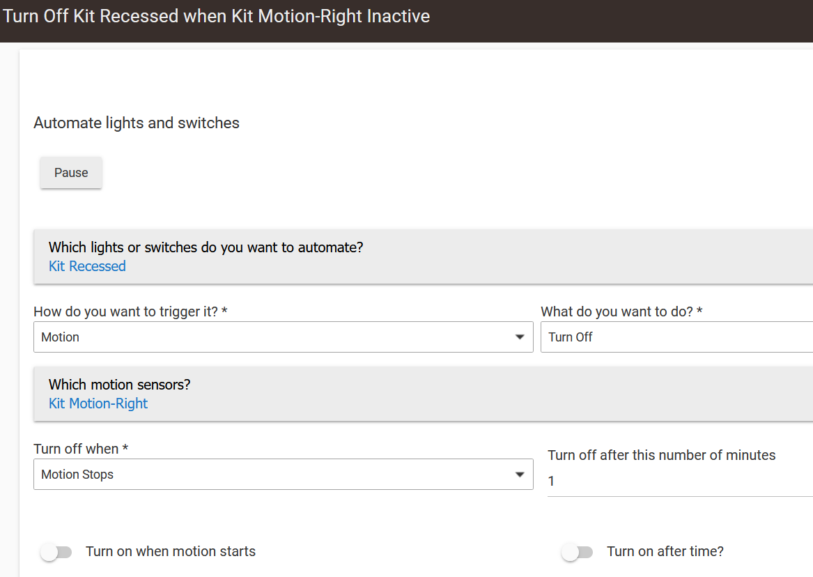

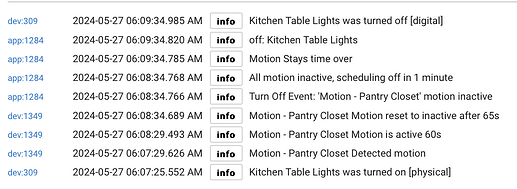

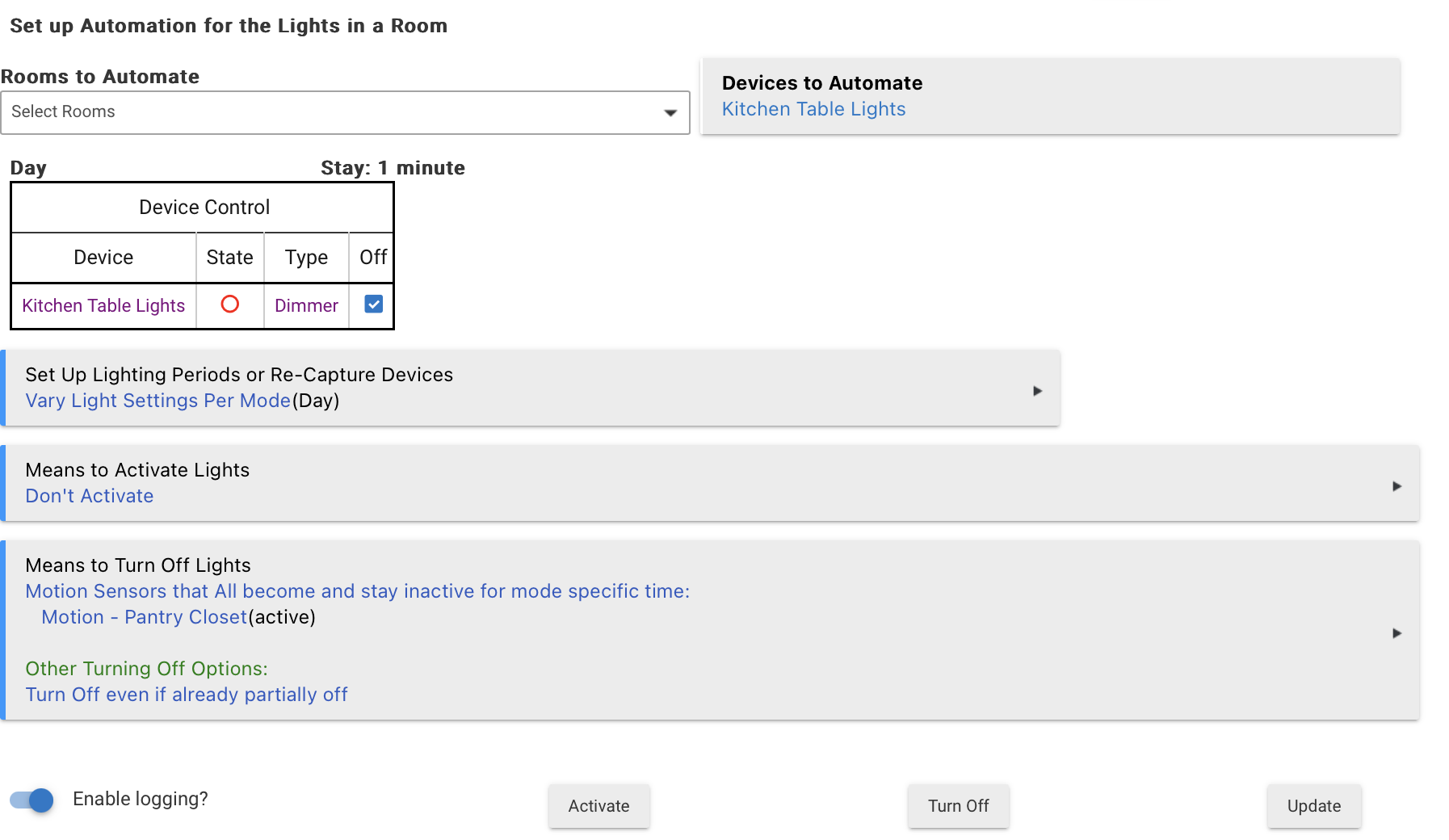

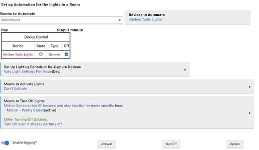

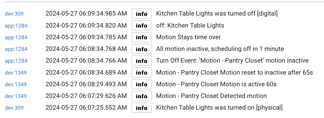

This RL setup should work. Room Lighting has very good logs. Here is an example that I just set up with the logs of the app and the devices:
If yours is not working as expected review the logs. In RL if you choose 'Don't Activate' you must also choose 'Turn Off even if already partially off'. Which you did.
As shown by other replies, there are lots of ways to accomplish your goal. I pretty much always use RL when possible as it is purpose built for managing lights.
