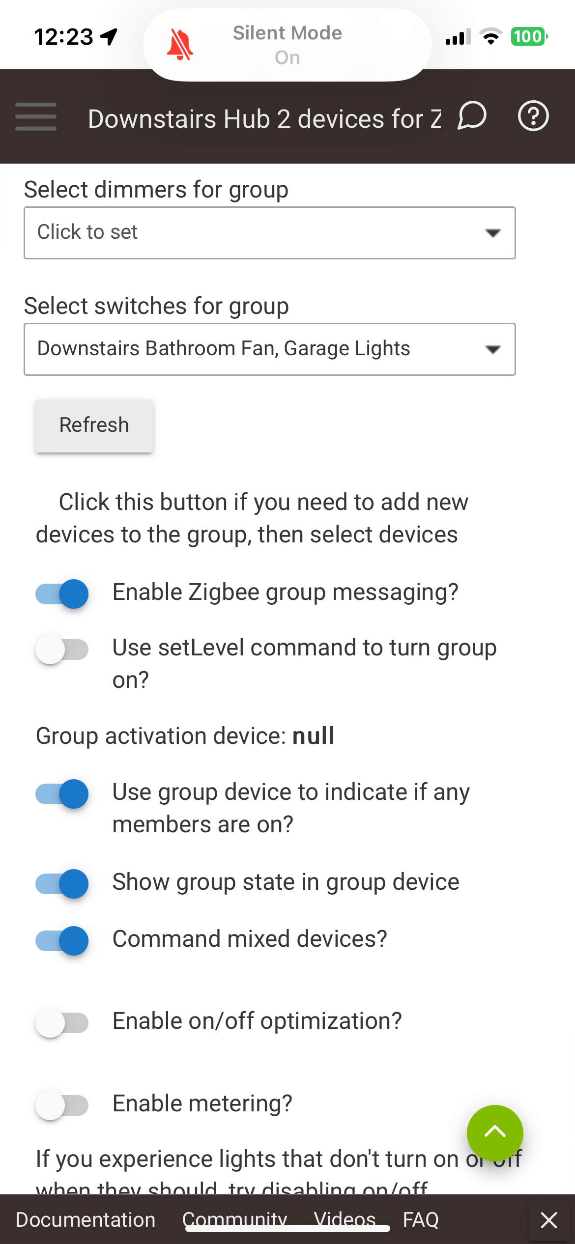

Ken, thanks for the response. All the switches are zigbee. Where is this option to enable group messaging? In Rule Machine?
You mentioned grouping them. If you group them all using the Groups and Scenes app, the option for zgm is in the group.
There is also Zigbee group messaging support in the Room Lighting app as well.

I used the grouping smart app and the ZigBee messaging option, and it has corrected the issue. Everything is working correctly now! This allowed me to add the group device to my rule and remove all the individual devices.
