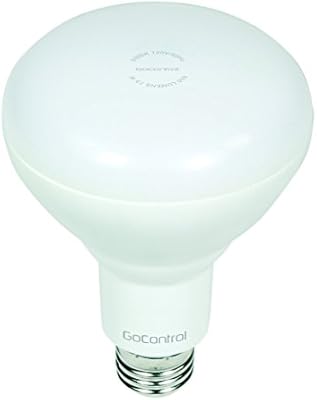

I have the z-wave plus bulb from GoControl. But looking at Amazon, it's now only available from resellers for OVER $60! However, it looks like it's also being sold as a NuTone brand now: https://www.amazon.com/Bulbz-NLB60Z_ZWA-NuTone-Cert-ZC10-15040004/dp/B015WN0662/ref=sr_1_11?keywords=nutone+z-wave&qid=1563459811&s=electronics&sr=8-11
$16. I've been pretty happy with mine.
Just keep in mind that NuTone dropped their home automation business at the end of 2017. They will honor warranties for products purchased before then.
Interesting. The one z-wave bulb I have is in a fixture that is constant power. If that smartbulb ever goes out, I will probably try to hide an Aeotec Nano up in the ceiling and just use normal bulbs.
