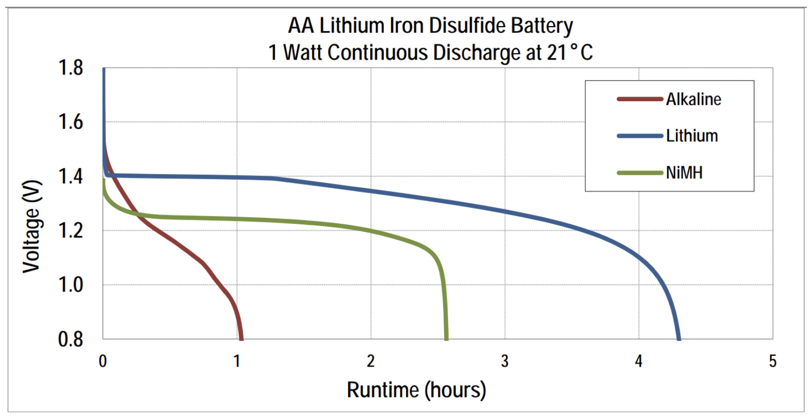

While this will vary with discharge current load, the discharge profile of lithium can be very steep .....
Especially when powering something motorized versus a sensor. Like how a lithium power tool works right up until it doesn’t.
