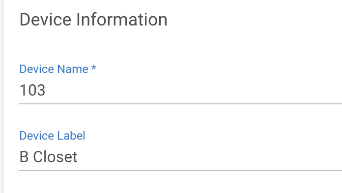

Here's an example Lutron device:
The Device Name, 103, is the Lutron system device id number, and this device is called "B Closet" in my hub. If this device were added to a new Lutron system that assigned some number other than 103, I could just change that Device Name to match. You should make sure that the settings for the Lutron Integration app have all of the new Lutron device id numbers and associated device names.
