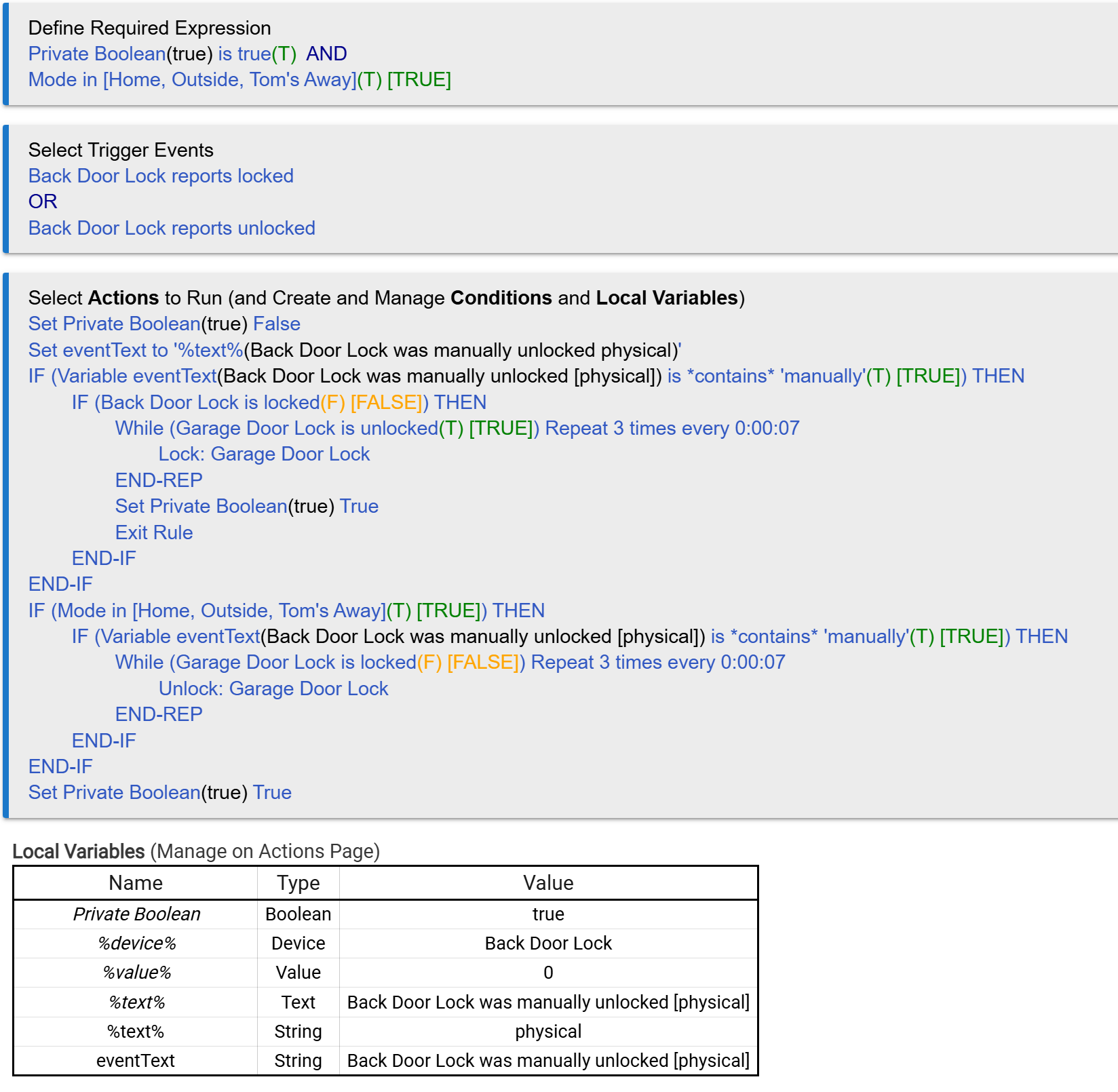

I was simply matching on text in rules. This works now. I used to match on "thumb"
What is this setting??
Matching the event text in the rule for "manually"...vs..."thumb" in the non-JS ZWAVE version of the antenna driver on the hub.
