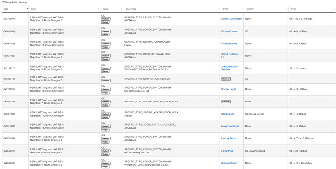

What's the RTT look like on it? The only time I've seen similar is with ghosts in the mesh so that it's trying to send twice when one isn't there. Can you post a screen shot of your z-wave details page?

Yeah, I've got at least one ghost I guess:
Possibly 4. Also, several S0 paired devices that should optimally be paired with no security.
At least. All the ones with Discover, and potentially others with no routing in the last column.
The "notification sensors" (4-in one or multi sensors) are typically the worst, they send lots of reports in the first place, especially if configured wrong for too often temp, motion, or humidity changes. Then add the triple traffic penalty of S0, and you are asking for mesh trouble.
Power reporting devices are also a cause for crashing the mesh if configured in incorrectly.
And is that a Zooz Zen25 on 0x2B? Those are known offenders to be very damaging to Zwave mesh.
You've got 4. Get rid of those and see how things are. As @neonturbo pointed out, re pair the zooz sensors with no security. You may need to do that with a usb stick paired as a secondary controller
So is the only way to clean out ghosts the way using a usb stick?
Power down (actually disconnect the power) to the devices that created the ghosts. Shutdown the hub from the settings menu. Unplug at the wall (not the hub) for 20 mins. Bring back up. Start removing the ghosts..
