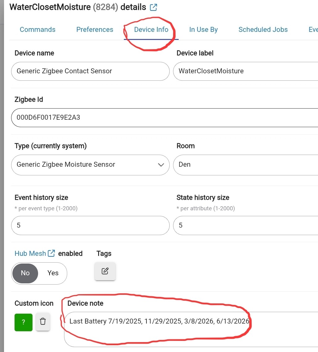

The other thing you can do also, is to start logging the battery change dates. I would search the forum for a few apps that can help, but you can also enter it in the device note block on the Device Info tab. For some devices, this may be the best way to predict when you need new batteries (like this one that is battery hungry)
