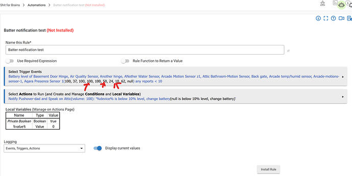

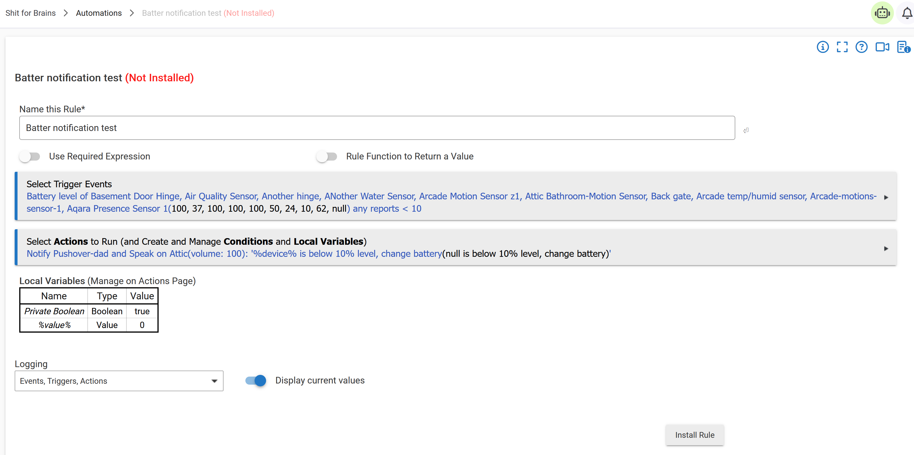

Another option is simply use RM to create a quick rule. Something like this would work fine
Perfect. That’s exactly what I was looking for! Appreciate it.
Quick follow up. When I use “Battery level on %device% is low”, I get “Battery level on null is low”. (No quotes).
Am I using that variable correctly?
Post your rule. Sounds like you haven’t selected any devices.
Isn’t it just because no device has yet triggered the rule?
Should still current values in the rule like mine above. The one null value is on the aqara sensor that is currently offline.
Possibly. I ran the rule manually with a known low battery device. I’ll see what happens when the rule engine runs it.
I think %device% gets populated by the device that triggered it. As such, I do not think running manually populates the device. So, it will be null until an actual device triggers it.

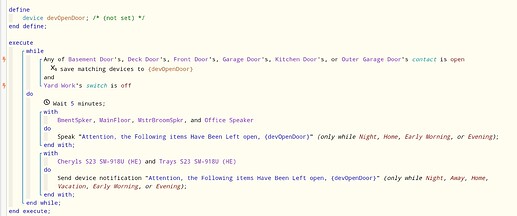

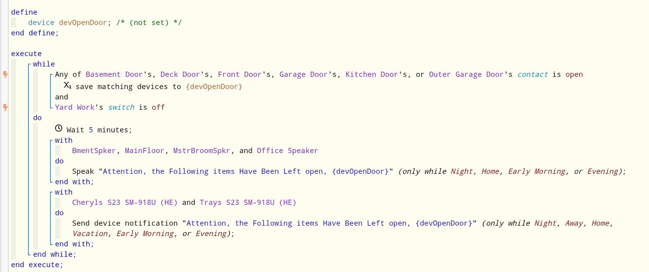

One drawback to using RM - If multiple devices trigger it at the same time - you only get notifiation of one of those devices in the message. I use webcore when I need a list of things meeting conditions (Like this one for doors left open)
Thanks. That makes sense.
