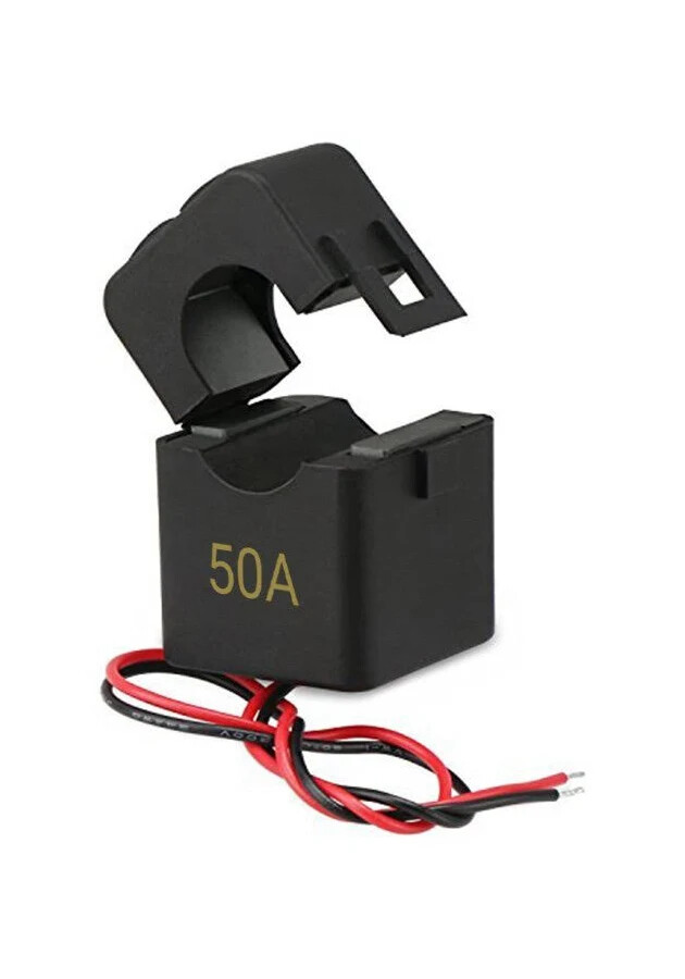

Can you drill a hole into the house then run a clamp with a lead into the house? If so you could use a monitoring clamp like this one and simply extend the wiring and weatherproof the hole you drilled. This would allow a monitor like iotawatt to be mounted inside the house.

Example
That's a great idea, the tails for the new fuse box are outside in the meater cupboard and i could try running the wire with the tails for the old fues box.
What are the clamps called on there own, just browsing amazon and there all the hand held type
Any should do, just make sure it matches or exceeds the amperage of the line you're connecting to.

Thanks, looking at them all cables are to short. Ideally need a meter long.
Would this be compatible
https://amzn.eu/d/dRnat9L
You can simply splice on to it. Length really doesn't matter. But yes that would work. @kkossev Do your drivers work with that?
